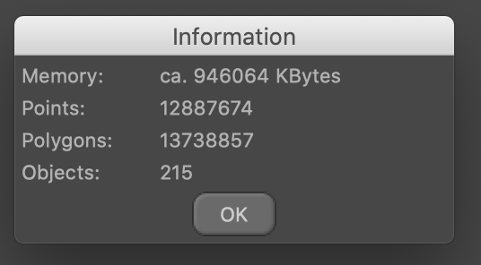

Hello!

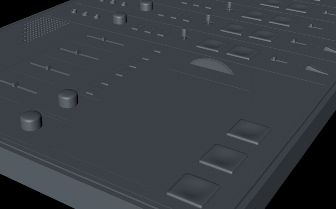

Starting to get a little frustrated. Have been modulating in cinema on and off for a long period now and thought I did everything right, but I'm probably totally wrong. Learned myself trough YouTube and a lot from different forums. Trying to create a simpler synthesizer with a few buttons and controls. Mixing regular modulating whit bevel the edges manually and where I create some buttons with subdivision surface.

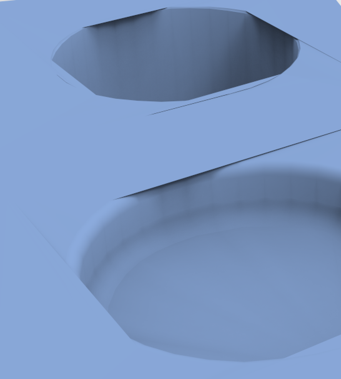

And now, when I'm almost done and I export it to keyshot (obj-file) it either goes slow (the file is to big) or it looks fucked up in keyshot.
From my insights and theories I have following questions:
- Do I have too much polygons? How to prevent that and make it still look smooth.
- Do I export the file wrong to keyshot?
- Am I doing the modeling wrong?
All help is appreciated
- Yes, you have too much polygons, 13 millions of poly is a very high mesh and handle this kind of file to another software can drive it crazy. If you want optimise the file you need to "clone" the similar objects by using "rendering Istances" but this works only if you stay into Cinema4D for rendering, if you export the file all become polygonal object.
- OBJ is a good way to export to KS, but you need to optimise del file first, otherwise key shot doesn't handle it smoothly.
- There are some parts that can be optimised, there are too many fillet or bevels and you must "take a look" to the final distance of the camera and put down the number of polygons for some object that will stay so far from the camera.
There are some high poly object that can be optimised with a low count poly otherwise you will handle a very big file.

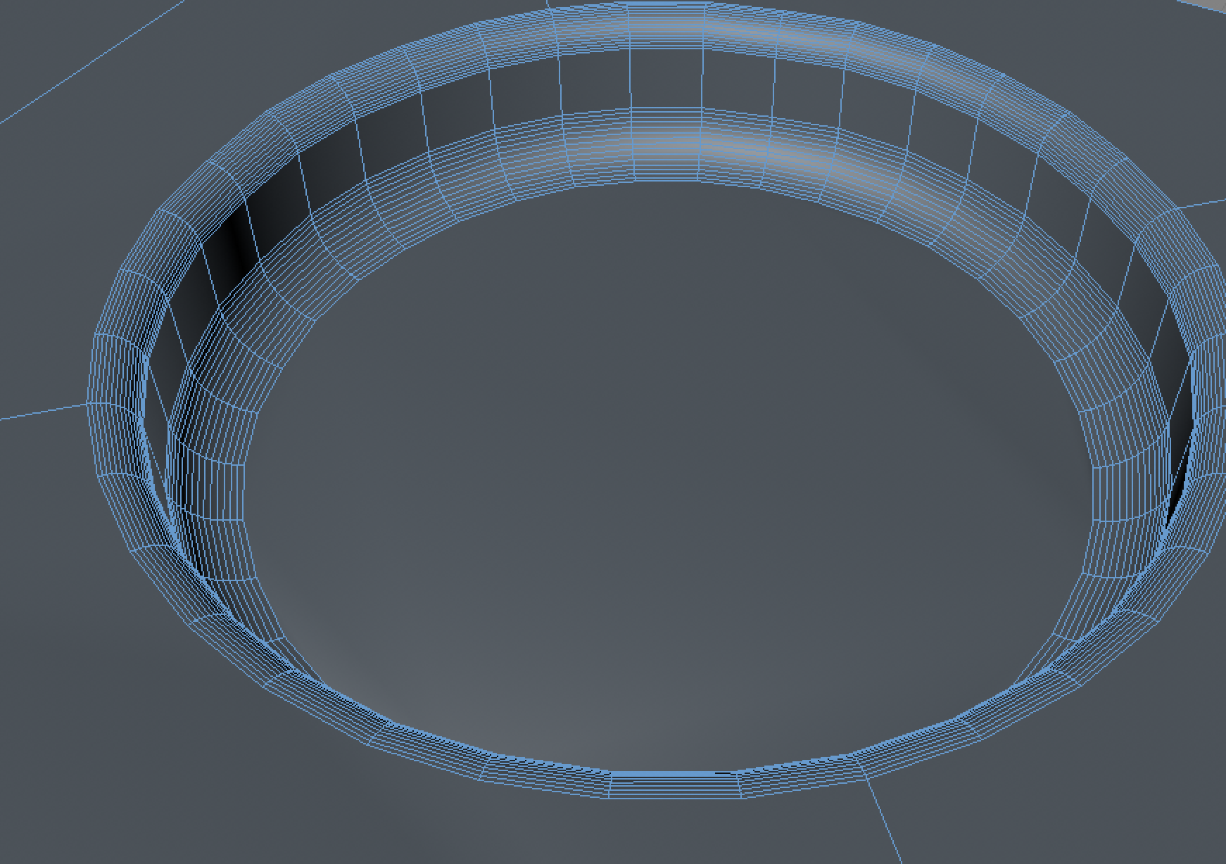

About your question, maybe Bevels are the problem here, but the only way is to reduce them as possibile, for example you must reduce the bevels count, in my attachment you can see a 5 steps bevel and 15 steps bevel (as you).
With 5 steps you can get a good smoothing curve as well.
If you have subdivision surfaces with a polygonal object inside for smoothing, try to reduce the render quality to 2 instead of 3, this will take place when you export to OBJ, so take a look to the "editor subdivisions and render subdivisions" of each Subdivision Surfaces object and use 2 on the rendering subdivision to get few polygons during export :)
