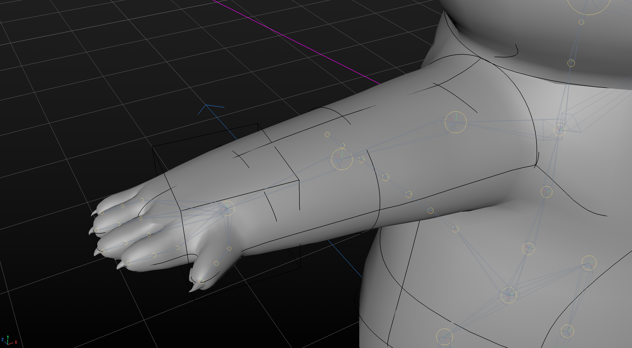

Hi. i use c4d since 2 years, and now i have a problem
i want to attach a spline point selection to a rigged mesh
for make it move with the model

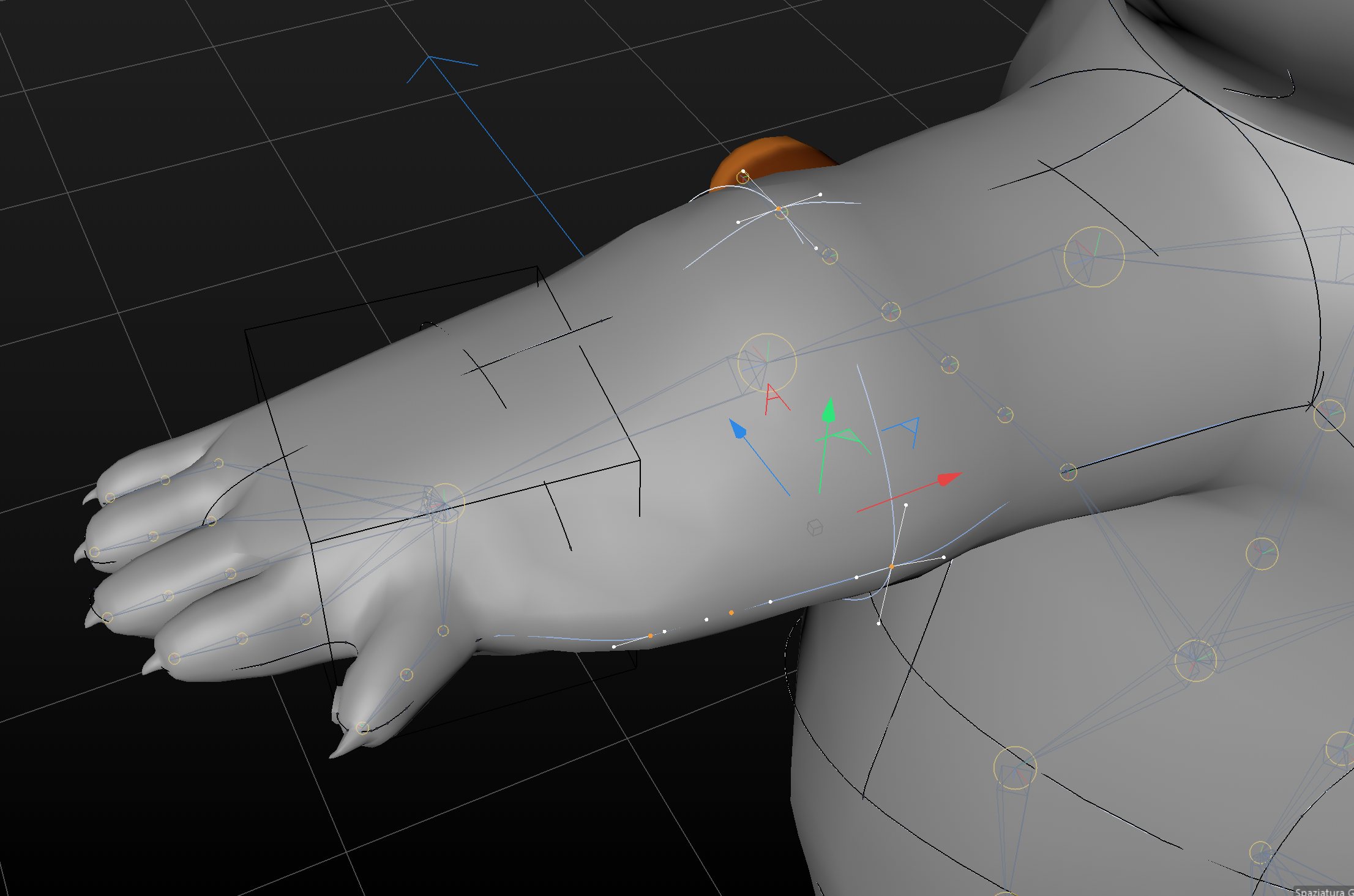

and use the spline deformer
for some correction without corection deformer.
can some one help me?
thanks.

Hi, if I understand correctly would you like to fix a spline to a mesh that will modify the spline which in turn will modify the mesh?
sounds a bit redundant to me.
I think it makes more sense to try to fix the spline on the joints...
I apologize for my bad english

I already tried ti attach ti joints but with consrtaint dosent work. I shuld try with xpresso?

I think so (but the joints don't necessarily have real positions like the vertices), and I foresee a very boring job. Alternatively, if the small changes to the mesh are not many, I would opt for the morph tag, which is very dynamic in these cases

Thinking about it, there is a trick to "attach" the points of a spline to the joints using an IK spline tag (not the way it was meant to be). I post it for the record
IK spline.zip
(77.42 KiB) Downloaded 363 times

IT WORK!!! THANK YOUN SO MUCH. YOU SAVE MY LIFE!!! I font know what i have fine without you. THANK!!!
