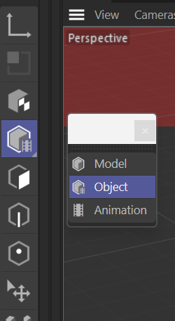

Hi, unless you did the scaling in Object mode (not the default Model mode)
Screenshot 2023-03-03 085519.png (37.67 KiB) Viewed 26913 times
, you can't see the scaling value of a group. You can, on the other hand, see the total size of a group via the coordinates panel, just change the reference value from Scale to Size+
