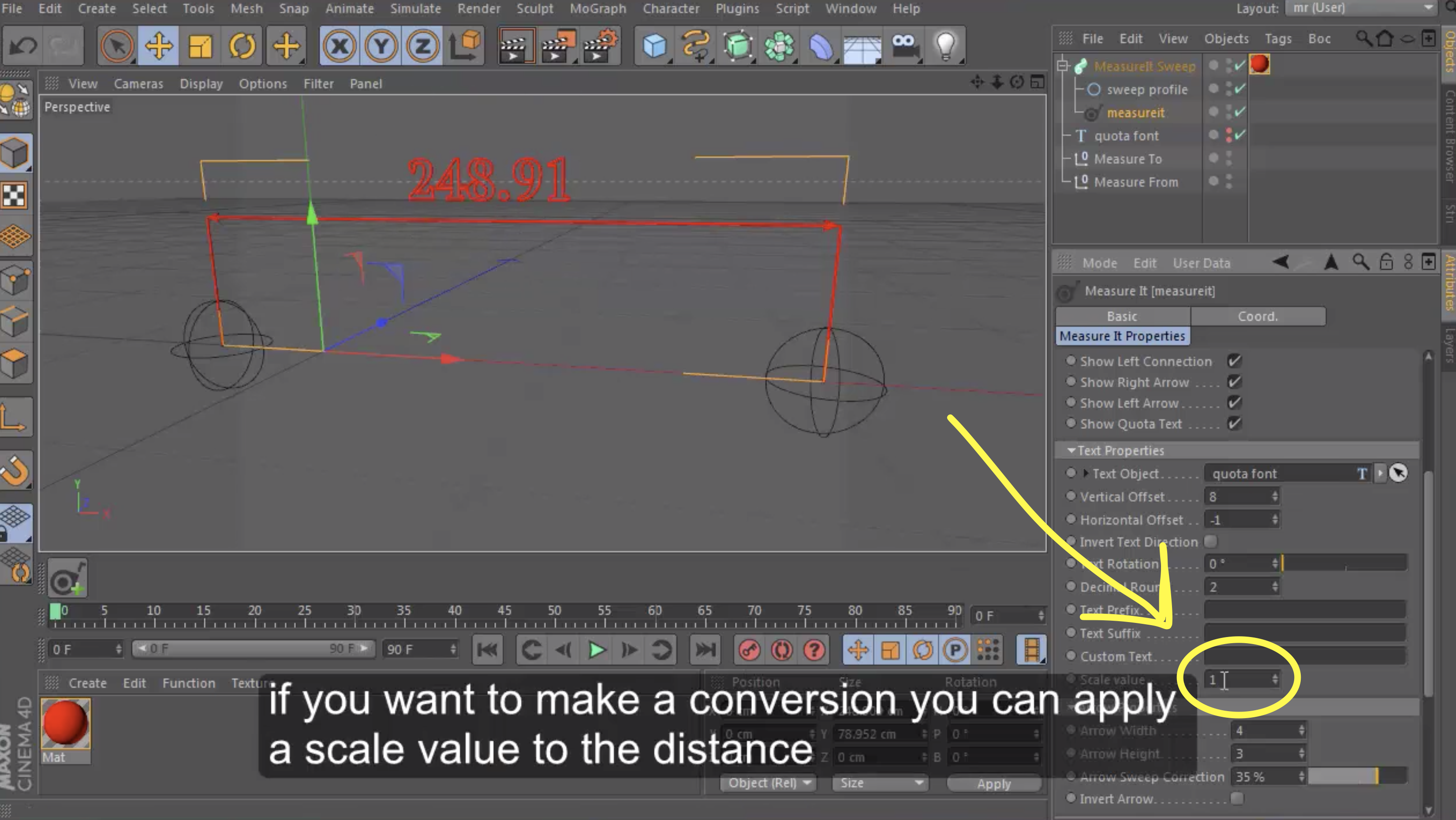

Hi all. It seems that MeasureIt cannot display any other units accurately aside from metric. The scale value does not allow for a small enough division of the metric unit. Any ideas how to to accomplish accurate Standard units, like feet? Thanks

I remember that you can calculate it by SCALE value to convert it to feet or something else :) Look to this screenshot taken from the Videotutorial you find into the documentation folder :)

I did see that, however the plugin's scale value is not divisible into .0348 (can only go to .035), which is what I would need to accurately convert from cm to feet. Anybody have any clues? This seems like it should be a basic function of a "measuring" tool.

Hi Jacob
you have to increase also decimal round property
