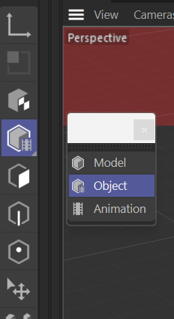

Hi, unless you did the scaling in Object mode (not the default Model mode)
Screenshot 2023-03-03 085519.png (37.67 KiB) Visto 19267 volte

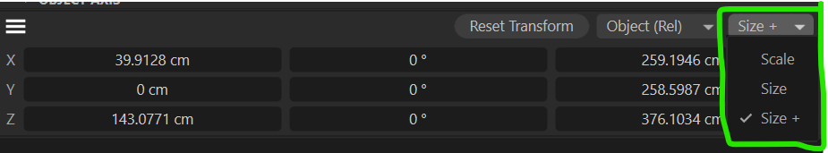

, you can't see the scaling value of a group. You can, on the other hand, see the total size of a group via the coordinates panel, just change the reference value from Scale to Size+
Screenshot 2023-03-03 085819.png (18.63 KiB) Visto 19267 volte

This is such a useful bit of knowledge! Thank you so much, visualtricks! :) I never even knew that could be changed!
