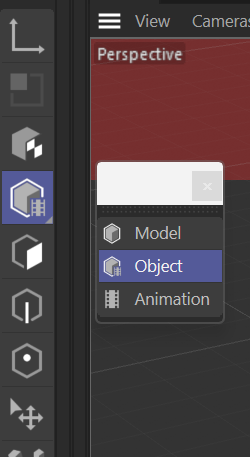

Hi, unless you did the scaling in Object mode (not the default Model mode)

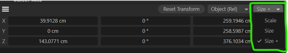

, you can't see the scaling value of a group. You can, on the other hand, see the total size of a group via the coordinates panel, just change the reference value from Scale to Size+

Re: Scale a group of objects proportionally?
Inviato: ven mar 03, 2023 1:36 pm
da MelodyJane
This is such a useful bit of knowledge! Thank you so much, visualtricks! :) I never even knew that could be changed!
