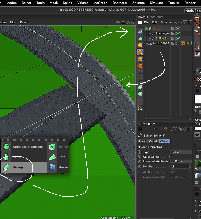

i am making a car racing track .... and i need same distribution, then i use uniform with SWAP TOOL
look the next picture ....
but please if you have a better way to make race tracks i will apreciatte so much ...
here i attach a picture but here is the game where i use those tracks on UNITY 3D.
[[ press RED buton to play ]]: https://ufulio.itch.io/mautrack-test-002
road spline 2.jpg (267.17 KiB) Visto 32112 volte

In the picture you already distributed correctly the topology because you converted the spline into "uniform" interpolation that transfer to the Sweep generator the right way to create regular polygons topology.
I don't think you can distribute points with the same distance but the interpolation of the spline is the right way to generate a regular polygons street model...
