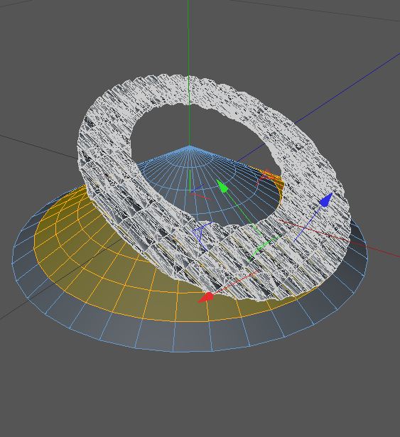

One thing I found is that the generator does not seem to work on round roofs (e.g. cone, see attachment). Is that something that is not possible right now or am I doing something wrong?

You can't make tiles on round roofs actually, sorry :(
