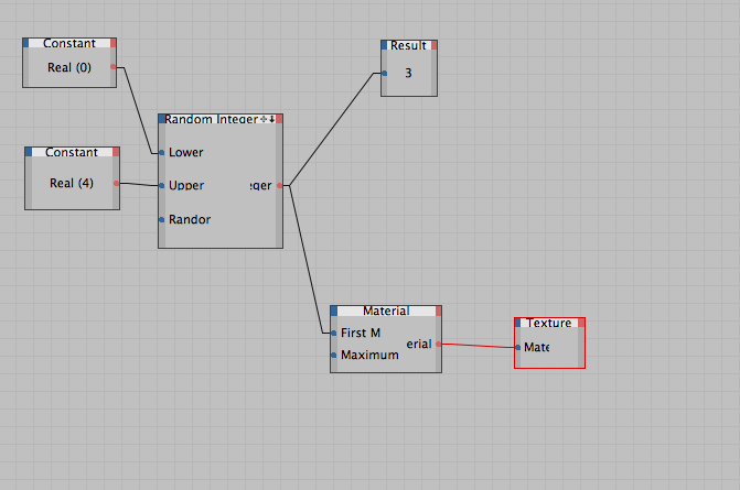

So, I made a simple xpresso expression. Instead of the collision node, I used random integer node to generate random material indices. My only problem is that it is generating them at each frame. How could I make the random integer node give me integers at certain intervals such as every 10 frames?
Thanks

metekutlu wrote:So, I made a simple xpresso expression. Instead of the collision node, I used random integer node to generate random material indices. My only problem is that it is generating them at each frame. How could I make the random integer node give me integers at certain intervals such as every 10 frames?
Thanks
Cinema launch Every xpresso expression at each frame as you note.
Search from the nodes the time and with math operator check that
Frame property module 20 (for example) =0
If true it means that elapsed 20 frames....this could be the main logic more or less
Modules is math operation that mean the rest of division by a number
Es:
8 modules 5 = 3

Math always saves lives! It is working. I just added a NOT after Math:Module, and then connect it to the Enable Port of the Random Integer. Thanks for being so clear and helpful. Here you can see the model. As my last question; would you propose I make selection tags for groups of faces and apply variations of this xpresso or is there any other fancy way?

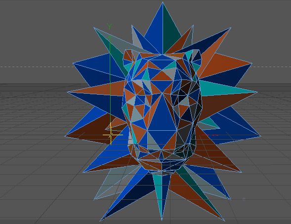

hey thanks a lot matteo! I attached the result for now. I'm very happy with it. I wanted to ask you if it's possible to make an animation with only visible edges (moving, being drawn in many ways), if it's complicated i prefer to do it in after effects then combine the animation? check out the scene! thanks.
lion 04.c4d.zip
(147.35 KiB) Downloaded 1201 times

metekutlu wrote:hey thanks a lot matteo! I attached the result for now. I'm very happy with it. I wanted to ask you if it's possible to make an animation with only visible edges (moving, being drawn in many ways), if it's complicated i prefer to do it in after effects then combine the animation? check out the scene! thanks.
:idea:
You're welcome and thank you too for sharing with our comunity your scene file
:P
When I will be free for five minutes I will watch your result...I'm very curios to see the final result...now I'm very busy with Master Cinema 4D course
:mrgreen:
I don't understand your request....What do you mean for "make an animation with only visible edges" ??

I just saw the courses, it's great. As for my question, I wanted to animate the edges of the faces. For example, edge lines being drawn from the center of the object or a line(s) moving on the edges. I can do it in after effects but if it's possible in c4d it would be much proper.
