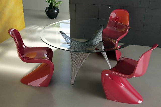

Modellato partendo da una superficie e hyper nurbs
aetan
Posts: 1039
Joined: Tue Dec 14, 2010 12:23 am
Location: Lyon (France)
Re: Help Tavolo Molteni Arc
Post by aetan »
ottimo ...
AETAN
Caleidos4D
Posts: 72
Joined: Tue Sep 27, 2011 4:48 pm
Post by Caleidos4D »
Ottimo Lavoro, bravo :)
