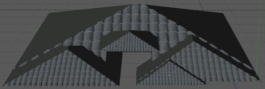

Help........I used the same settings for each roof surface, but the tiles on each surface are different scale-size [see attachment].
What am I doing wrong?

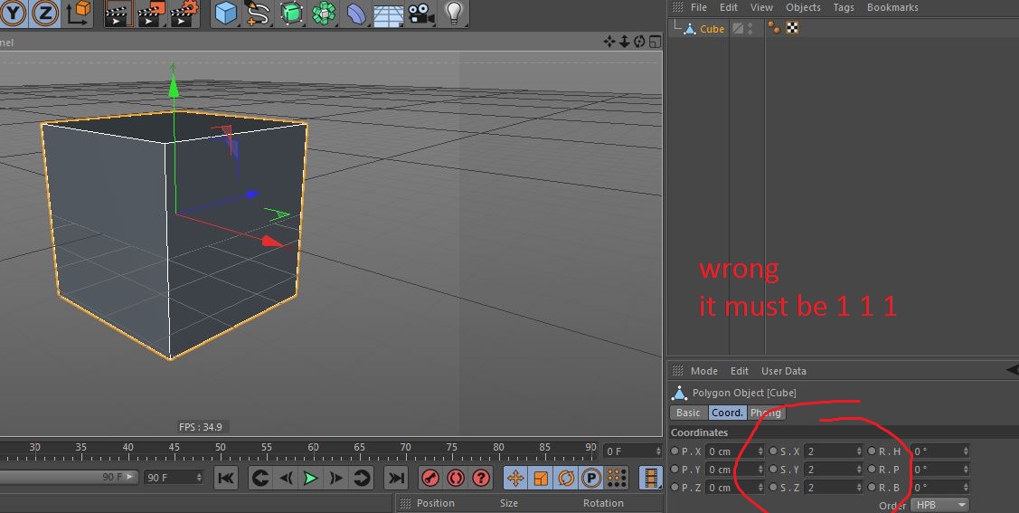

Hi
Probably your roof is made by more polygon pieces and each piece has got different scale
Check that your polygon objects have got scale 1:1:1 on the coordinates panel
If you cannot solve attach the roof below on this topic so I can check what is happend.
Let me know
Ps remember that tuilegenerator works with scale 1:1

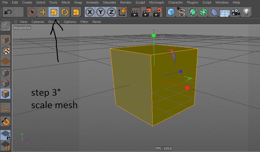

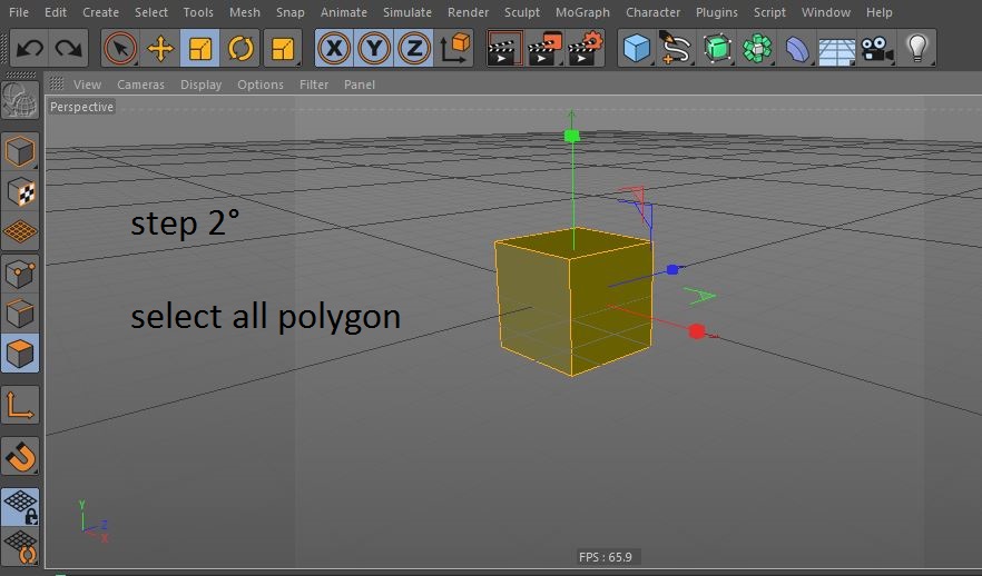

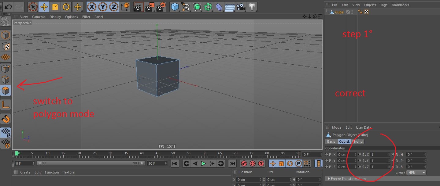

these are the steps to do in order to scale the mesh of your roof without using scale matrix
If you need to upload something on the forum you need to zip it, only jpg are allowed without compression.

Here are the steps, if I understand right from the pictures:
[1] Set scale to 1:1:1
[2] Go into polygon mode. Select all polygons.
[3] Scale the mesh [while in polygon mode].

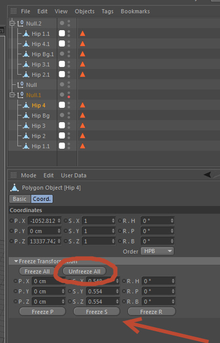

the problem is that you have freezed also the scale :o
did you import the model from a cad? because it's the first time I see a roof with Scale freezed, usually the freeze command is used only for animation not for modeling.
click unfreeze all button and set the roof scale and frozen scale to 1:1:1
than follow the steps I described before

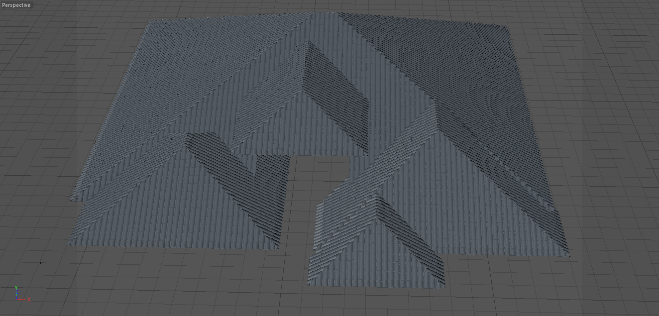

I repeat again, the problem is not on Cinema but within the model
see the attachment, there is your model correctly set to scale 1:1
you need to set each object to scale 1:1, remember that in Cinema an object inherits his scale from his parent and your null parent has got also scale different from 1:1
