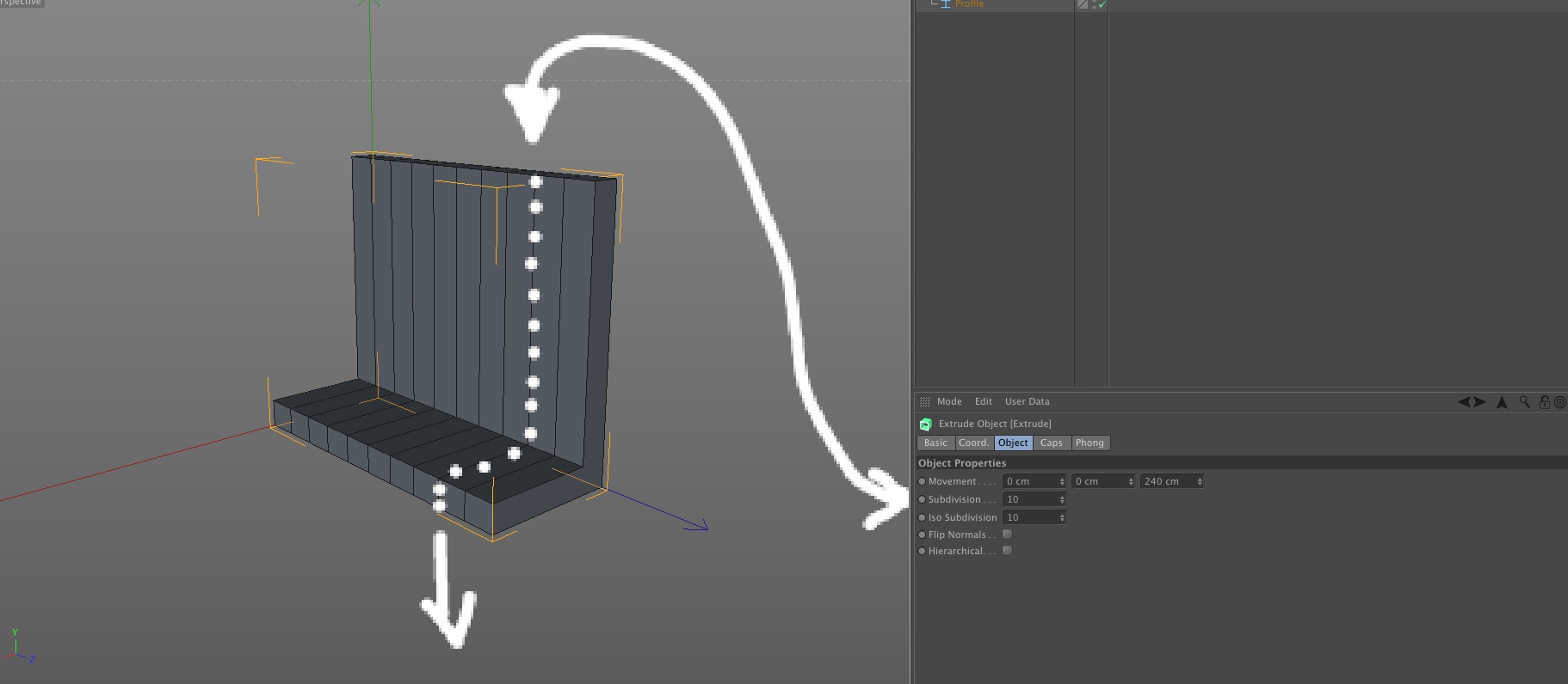

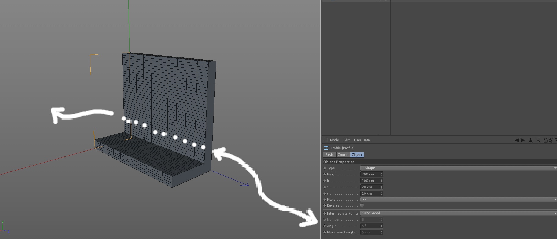

Hello! about subidivisions, take a look to my draft pictures taken from cinema4D editor :)
If you need to bend your object you must subdivide your object my choosing the right way where subdivde polygons. If you use the subsivision into the extrude nurbs parameters the cuts goes in vertical way, if you change the interpolation method into the spline and choose "subdivided" you can cut object into hotizontal way...
I think now that bend deformer doesn't works good because you need to bend the object into two areas... pfiu
