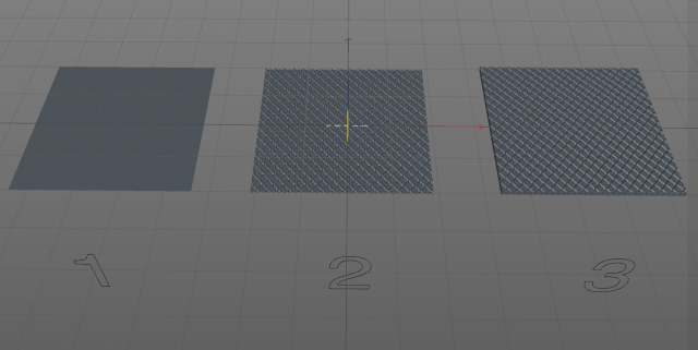

Hi!, I think that the displacement is a good way to get a good results but not with material (vray or c4d).
You should be able to get this kind of material by using the displacer deformer (blue icons on the tool bar) by apply it on a plane object with many segments.
This kind of way could be help you because when the results is good you can "current state to object" and convert it into a poly object, than you can estrude down all poligons and make it solid before the chocolate cream...
When you try to extrude all, go into the poly tool and move tool and select all polygons with (ctrl + a) and drag down the Y axis with CTRL pressed, don't use the extrude tools because you have curved poly and errors could be occurs..
alex
ps: the sculpt should be another good way but you need a little bit experience with it

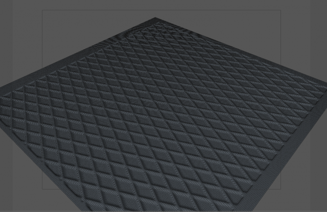

Hello Alex,
Thanks so much Alex, as always.
This is what i get, now do i have to select the lower vertex and pull them down to get more shape?.

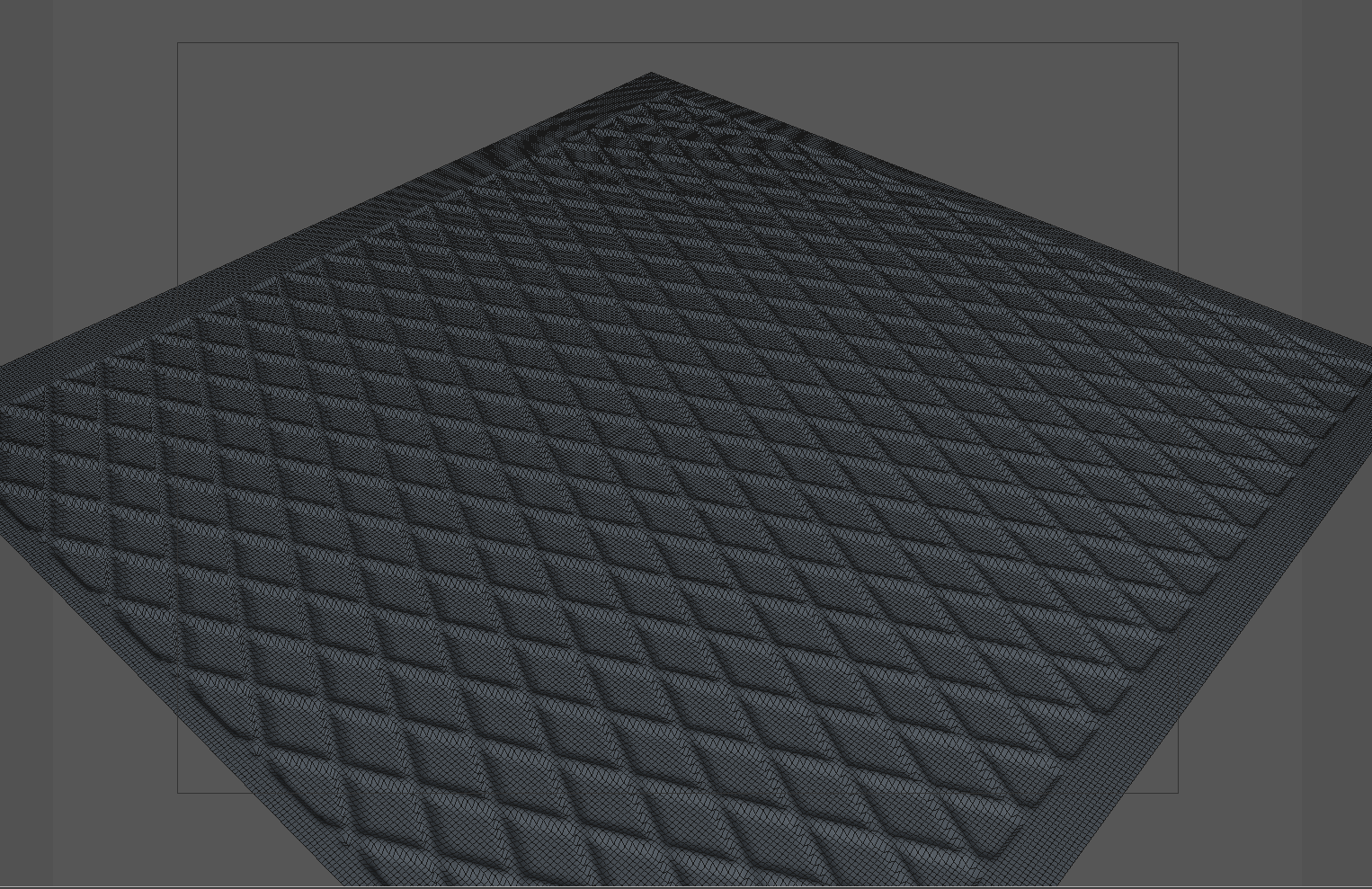

Alex,
Can i ask you if there is a way to get this ¨ Crush ¨ against waffle cookie chocolate effect?.
Posts: 10608
Re: Help Modelling Waffer cookie
Do you mean the "cutted" border? I painted it with a red color
Could you attach a picture about the actual results of your mesh? near the border?
