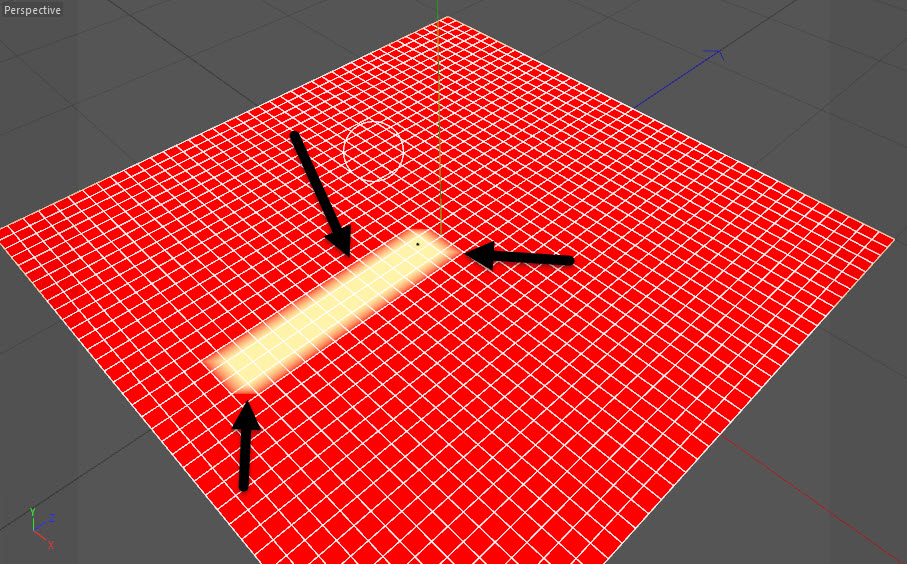

Hi Jochen
the answer is yes but the Vertex Map Animator is not the right choice, the final result may be not very good due to the mesh topology size.
You have to increase a lot the subdivisions but you cannot remove the tesselate effect anyway.....you can just try to reduce the effect.
The right choice to do this animation is using another plugin, the UVW Laser which is dependent to the UVW instead of mesh topology size
http://www.c4dzone.com/en/shop/plug-ins ... -1-266.htm
In the attachment there is an example scene if you want to try the effect
