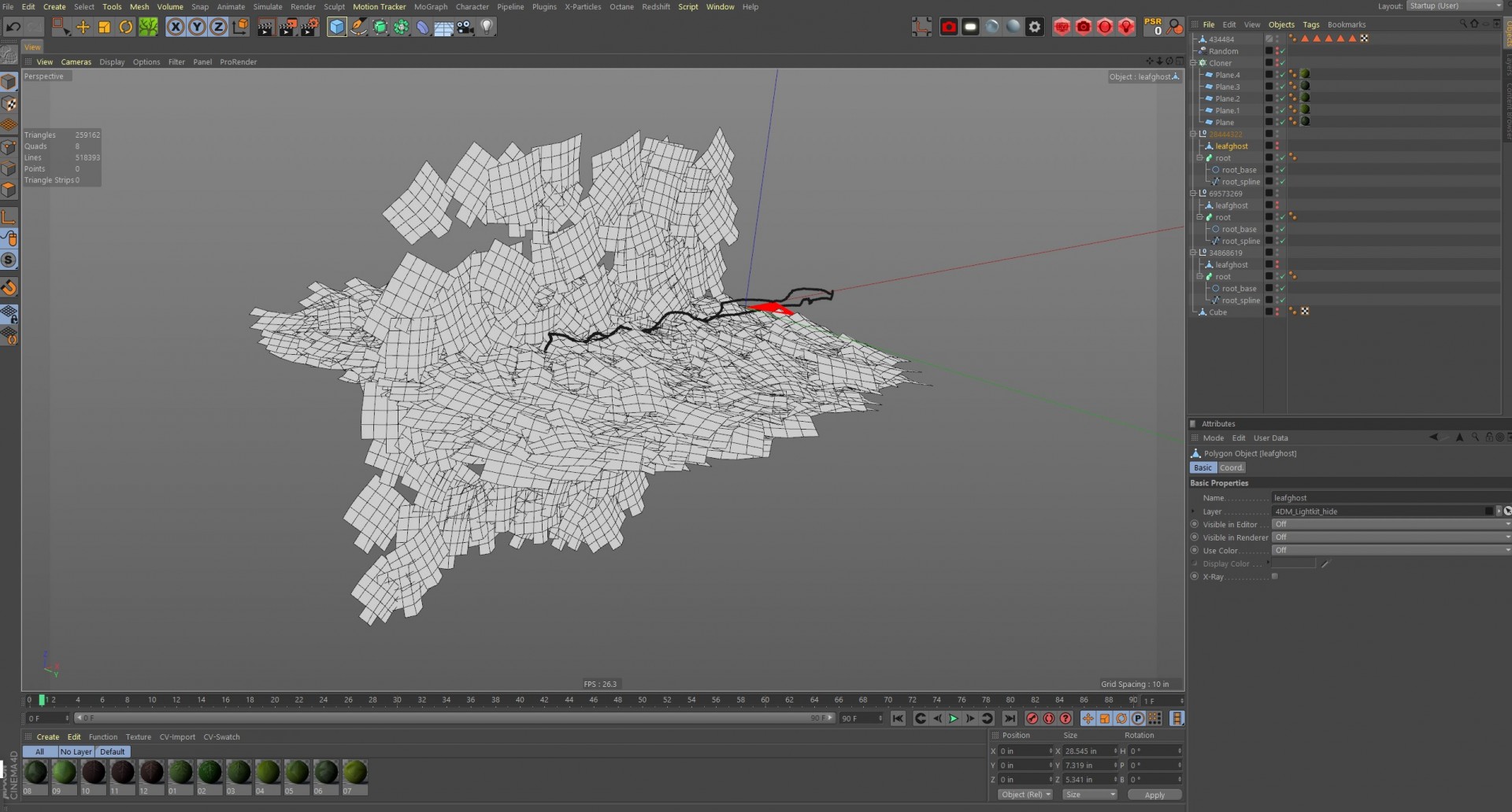

Trying to use the Easy Ivy Plugin. I watched the video first
I created a plane, made it editable. drew a spline.. no problem.
Selected the leafghost and clicked to create leaves.
he leaves are generated on a XY Plane and not near the spline.
how do i make them follow the spline when generated?

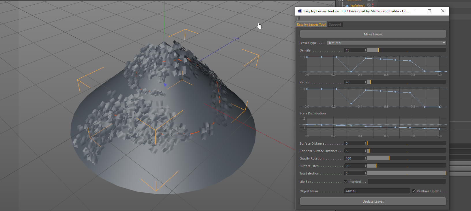

At first look it seems that the scale of your scene is wrong, and this could be the problem.
The scene must be scale 1:1, measure unit cm (the c4d default)
In the attachment you can see a simple cone cover with easy ivy
