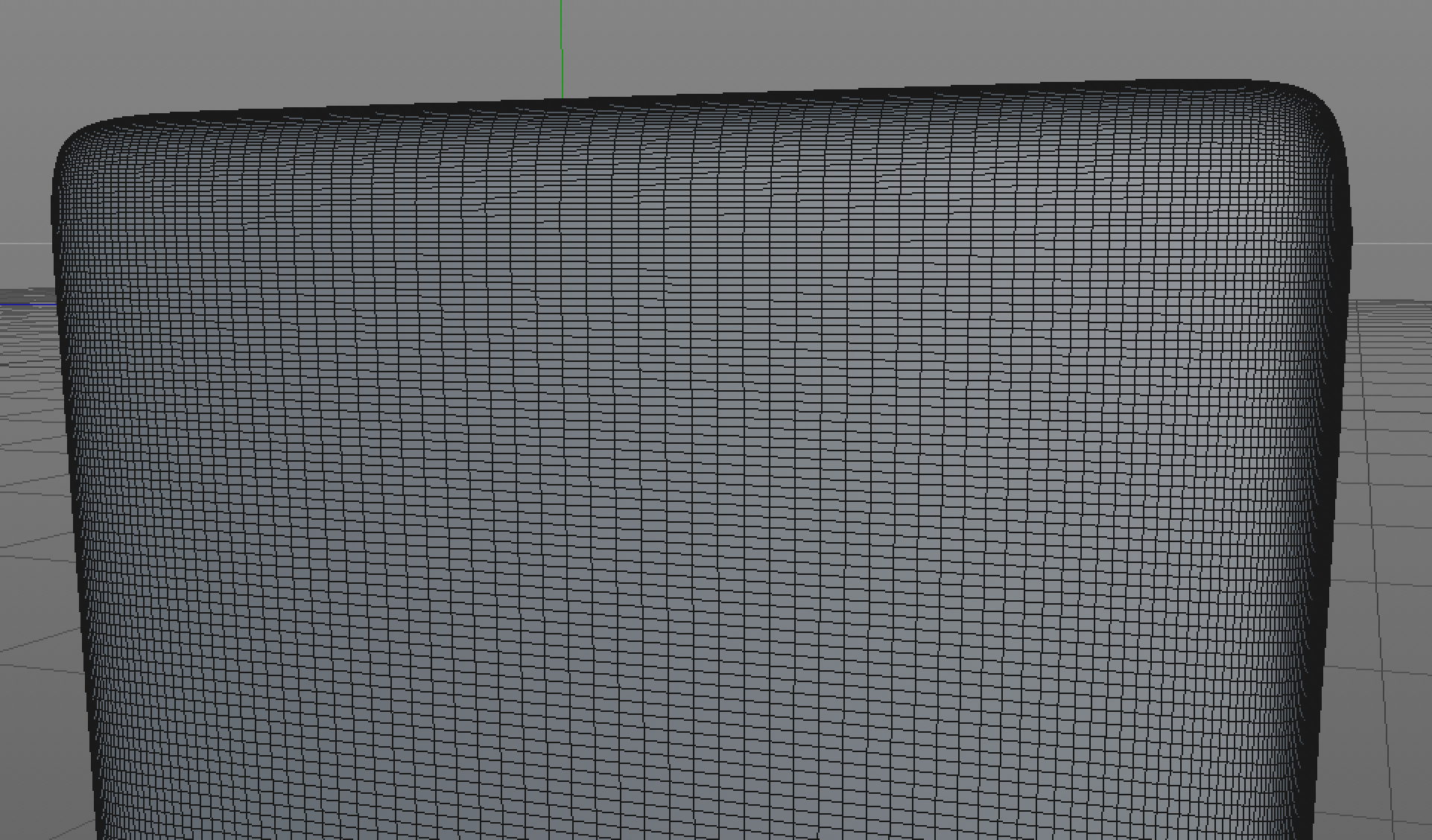

Posts: 10609
Re: Subdivision surface or Bevel manually
Thanks for your replay...
About your question, maybe Bevels are the problem here, but the only way is to reduce them as possibile, for example you must reduce the bevels count, in my attachment you can see a 5 steps bevel and 15 steps bevel (as you).
With 5 steps you can get a good smoothing curve as well.
If you have subdivision surfaces with a polygonal object inside for smoothing, try to reduce the render quality to 2 instead of 3, this will take place when you export to OBJ, so take a look to the "editor subdivisions and render subdivisions" of each Subdivision Surfaces object and use 2 on the rendering subdivision to get few polygons during export :)
