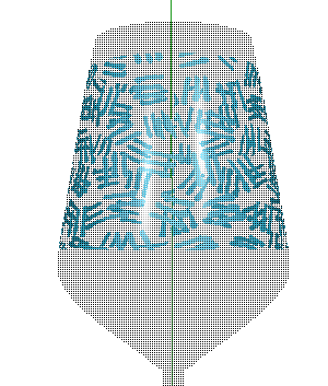

Hi everyone !
Here is my problem : I need to apply various pattern designs on 3D glass models
Here's what I'm looking for : https://imgur.com/l2PlG6n
Here's the issue : https://imgur.com/XeO5OwC
I use UVW Mapping on my pattern's material with "Simple projection" and side to "Both" with the "Tile" option.
On some models, the pattern get distorted, much bigger on the parts that are rounded, not plane (maybe this is the reason?)
There's also some dots that shouldn't be here. You can see the original pattern : https://imgur.com/iuYWnzi
Thanks in advance ❤️
Posts: 10609
Re: Need help : Adding a pattern on a glass model
Hi Tom, welcome aboard. The problem is the projection, if you are using UVW mapping you need the unwrapped UV otherwise distortions occurs. If you are not into the UVW argument you must change your projection on something else like Cylindrical mapping to avoid distortion. Let me know :)

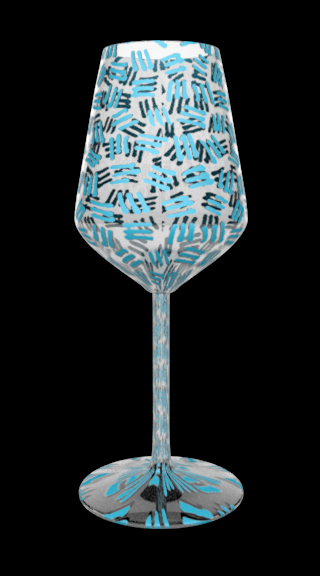

Thank you so much for your time, it works fine using cylindrical and fit to object ! But I still have an issue with some black dots appearing on the render. I never saw such a thing, maybe due to the glass transparency or something like that ?
tom.sb
Posts: 10
Joined: Wed Jun 03, 2020 2:44 pm
Post by tom.sb »
Sorry I'm quite a noob, didn't played with C4D for a long time..
My pattern gets black on the back of the glass. I just changed the glass material a bit but not sure this would make this black. Also switched my render settings to physical. But at least the dots are gone !
