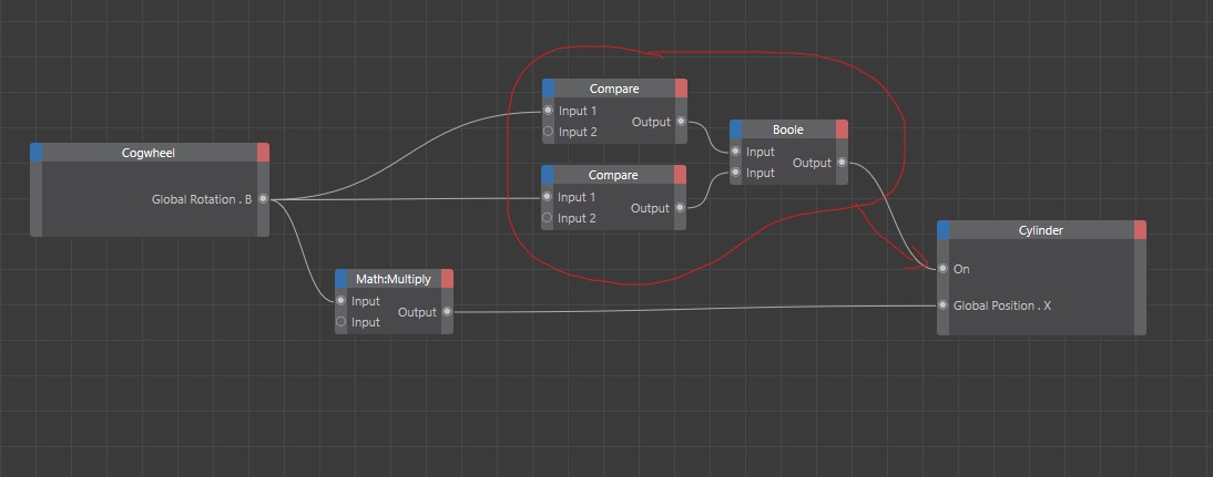

Hello! Can you please help me with Xpresso node settings)
I have a gun animation set up. The 3 gears are spinning (by Xpresso). The third gear should move the red part (above this gear). I set up, but the red part begins to move along the Х axis at once as a collision occurs( it is necessary that it moves during all collision time (third gear - while collision - red part is moving). how can i manage this right way?)
video by link below) + screen xpresso editor
thank you!!

Hello, I have seen the references and tried to understand the problem, I think without success!!
From what I've seen, however the approach should be more mathematical (without using "physical" nodes like the Collision node).
I've prepared you an xpresso schematic for what appears to me to be your question...
Cogwheel.zip
