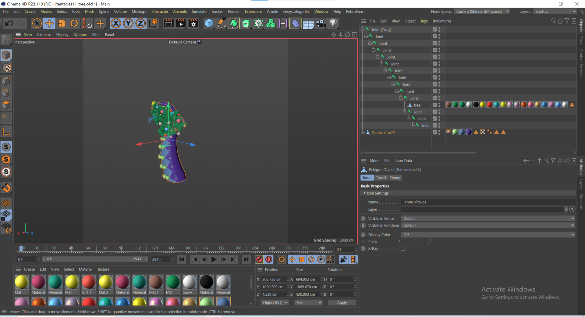

Hi! I am struggling to export GLB file with animation. Tried different options , including first to export as alembic file, but they didn't work. When I import GLB to blender or to https://gltf-viewer.donmccurdy.com/ it shows just one fame.
I uploaded the c4d project to google drive, maybe somebody can help me out.
https://drive.google.com/drive/folders/ ... sp=sharing
Thank you, Nataliya

Hello! Nataliya welcome here.
I think you need to change your animation workflow otherwise some parameters become incompatible. Usually when you make an animation with joints some issue occurs during export because some joints are not really animated but moved by kinematic tag...

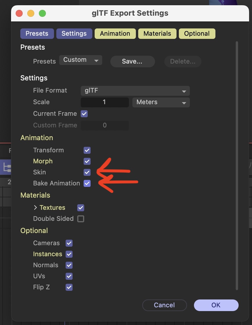

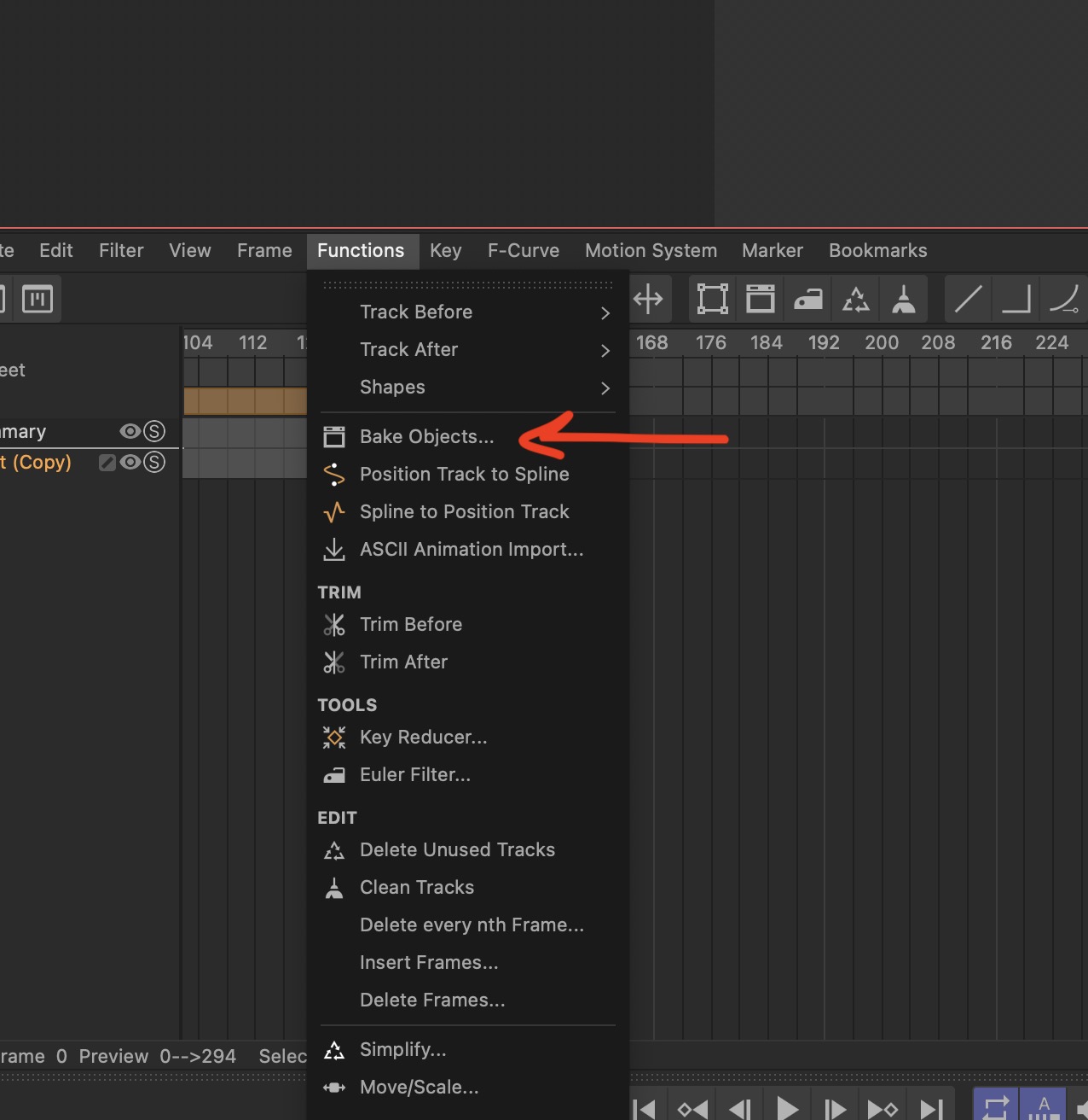

You must bake the animation via timeline and try to export via GLTF directly. (with some special settings too)
If you export your animation to GLTF, you can see only the Christmas tree moving, this because you animated It via keyframes (high compatibility) and not the joint movements (low compatibility).
So try to bake the animation into the timeline and try again :)
here the GLTF exported with baked animation: www.c4dzone.com/clienti/tentacles11_tree.gltf.zip
If you want to learn about, here below you can find a screenshot with bake animation feature from the time line...remember to select ALL parameters into the bake system and also remember to activate into GLFT parameters the "skin and bake animation"...flags
