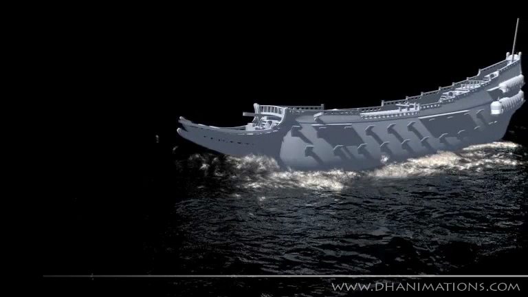

So i got the TP particles being produced by the collision of the two surfaces, i made a proxy of the ship for the particles to collide with, made some gravity to bring them back down and then i got them to land on the sea (with sreks - TP move on surface).
Now my next problem, and the reason why your not looking at a nice test rendering just yet:-
The sea is made sealike with a subtle displace deformer, and the TP particles fall through it after a couple of frames.
Does anyone have a way round this problem?
mikeb
Posts: 139
Joined: Sat Jan 02, 2010 12:31 am
Re: Making waves..
Post by mikeb »
I went back to the start and thought how i could use some of the other functions in c4d.
I decided what i wanted from the simulation which was lots of little objects reacting to the front of the ship, then moving down the sides of the ship, some being carried away by the waves..
I began toying with mo-graph dynamics and guess what, it worked a treat. It even managed to deal with the deforming ocean geometry & the actual ship model instead of the proxy!
With some well thought out expresso to tell the mo-graph particles where to start, It even calculates quickly, the render taking under 10 minutes for a 540 frame animation (without sim cache).
http://www.doghouseanimations.com/pirat ... 20test.wmv
Now i do have a couple of questions:-
1. Can the rotation calculation be turned off in mo-dynamics? (to speed up the simulation)
2. The clamp constraint (used to hold my ship to the ocean) produces very bumpy results (seen in the inset clip) even as "phong normal" setting, even though the mesh is quite smooth. Why?

After fighting an uphill struggle to get the dynamics i wanted, now i discover it won't work with metaballs.. Not in 11.5 anyway..
So i've had to move for another effect, this is my 3d sprites (complicated but works out best so far).
It is in no way finished but this is where I'm going at the moment, check the video below for the animation..
http://www.doghouseanimations.com/pirat ... ticles.wmv
