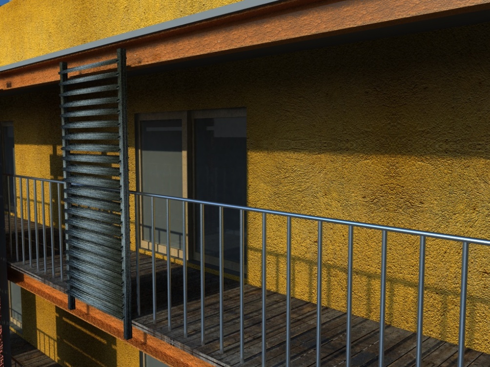

Help with my first render in C4D
I can carry on working without help. Could you kick me a little bit and tell me in which way can I make the model more realistic.

Re: Help with my first render in C4D
you must supply a bit more informations about the scene, the engine and render settings you're using, how are you lighting up and so on..
At first sight it seems you have some kind of filtering going on that is blurring many parts of the image, you may also want to work better on textures trying to avoid tiling and repetitions. For the lighting you should try to brighten that dark portion under the porch, but how really depends on how your scene is lit up.
Cheers
Vis.
Try to follow Visualtricks tips and give us other renders to view
