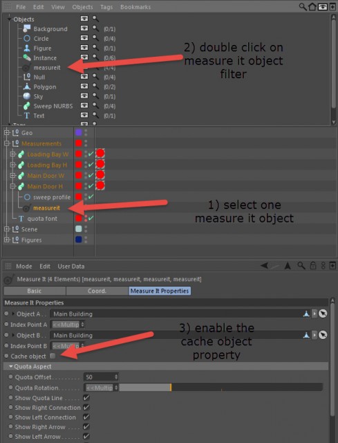

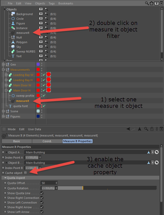

Ok now the update is ready
Once you have setup the style of your measure it objects enable the cache object property,
you can do it in one time, follow the screenshot
With this option the plugins will be refreshed only if measured distance change so this will increase the performance of the editor
How to update the plugin:
Download again the package and replace the plugin folder measureit
If you get error messages on console please
- Close Cinema
- Go to Cinema 4D preferences folder under subfolder "pref" delete file "symbolcache"
- Restart Cinema
