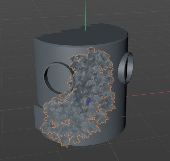

Hey!
I'm trying to get easyIvy to generate leaves on a surface. But it seems that they are being generated with an incorrect orientation.
Here is an image:
and my cinema 4d file:
https://www.dropbox.com/s/unvi39l176nhp ... e.c4d?dl=0
How could i better align the leaves with the surface of the object?

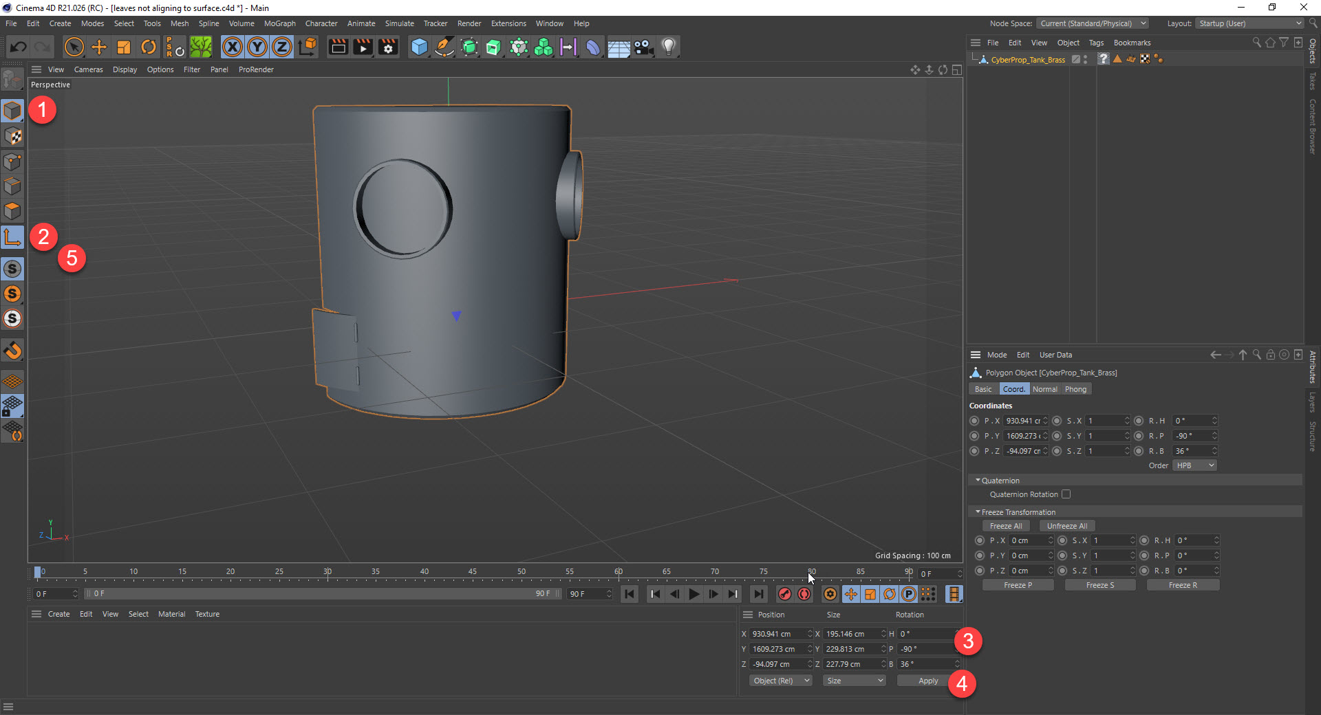

Hi it's a problem with the rotation of the object
to fix
1) go to model mode
2) enable axis modification
3) reset rotation
4) apply
5) disable axis modification
paint again the root and it will work
