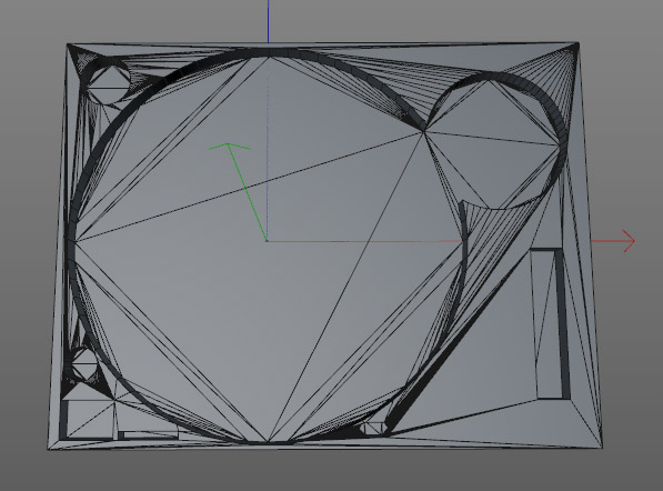

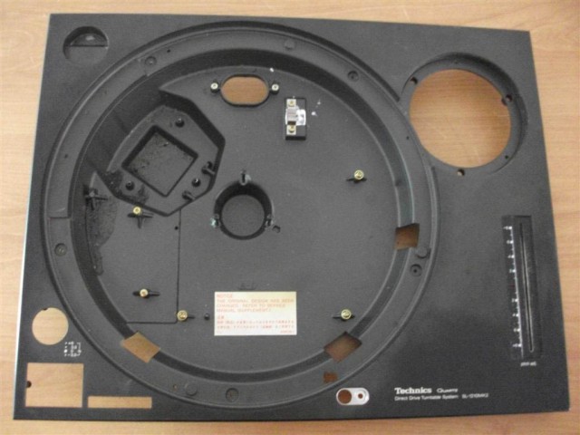

My actual project is to model a Technics SL1210 MkII Turntable, as detailed as possible (Image 1). The parts are very geometrical (Circles, Rectangles), nothing really complex in this Object.
However, I can't figure out how to avoid Boolean operations to model the Case.

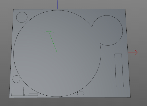

Using an orthographic Image of the Turntable, I created Splines to model the Cutouts (Image 2). I subtract those from a rectangle spline, which represents the complete case.
Then I tried two methods : Combining all Splines (Cutouts + Rectangle Case) using Spline Mask Objects to one single spline which is then extruded.
The other method : Combine only the Cutout Splines, extrude them and Subtract this Polygonal object from a polygonal rectangle (the Case) using Boolean Operations.
In the end I use "Current State to Object" to make everything editable.

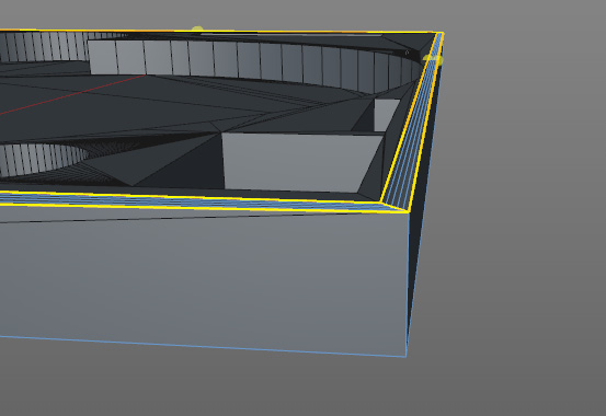

In regard of the result, both Methods work good but the Topology of course is a Mess (Image 3). When I want to add a bevel to the Edges of the Case (the big rectangle), I get weird results. One Edge is beveled correctly, the others get subdivided but are beveled into the object and therefore flat (Image 4).. I checked the Bevel Attributes but could'nt fix this problem.
