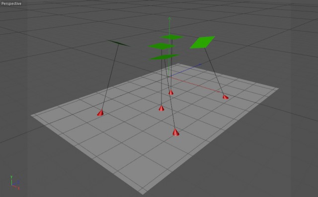

I'm sorry but I cannot help you integrating your requests within the plugin due to the complexity of the shape margin calculation that need to be performed in realtime many times for second..... pfiu
But
You can do what you need using a polygon projector and aligning each face normal to the zone where you want to cast a ray like in the example
The polygon can have disconnected faces and can project exactly what you want, of course you need to edit the polygon faces direction by hand
My advice is to use a standard ray projector to fill the surface as much better you can do and than fill the empty space with a custom polygon projector
Hope this help
