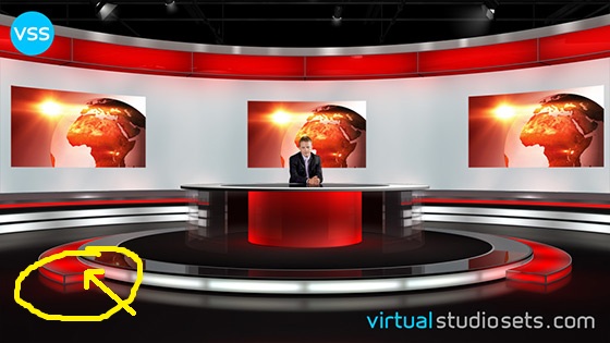

I have a trouble such as below image. How do i can make a material like the yellow circle.
I already made a material (red color for that object). And I do not know make a silver edge outside object)
Please anyone show me in details.
I can be reached at: minhquanhtv@yahoo.com
Thanks you so much
Messaggi: 10608
Re: Low poly car
hello and welcome on C4Dzone...
tips for the future, make a new topic instead to replay to another...
about your problem...
I think the best way is to make a material with a gradient shader into the luminance channel, enter into the shader and choose "circular" mode, change color nodes and apply to the object..
The only think you need to do is to apply it on polygons selections because on the corner you need only one circle but on the top of the structure you need different effects so try and play with the gradient :)
