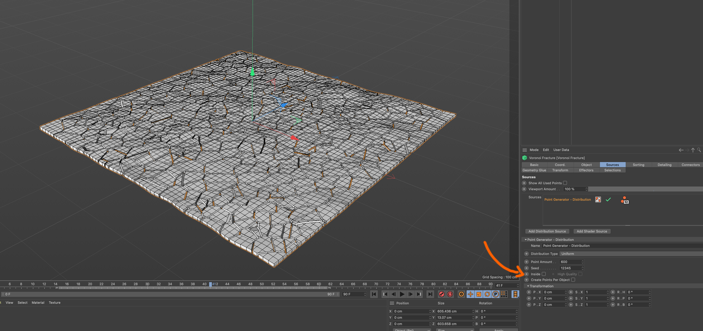

Hi,
I think I found it, but I'd still like to know why this is the solution. I simply deselected a check box called "inside". The image is attached.
What is the idea behind this check box?
Thank You
Dave
Messaggi: 10601
Re: a way to freeze vornonoi fractures?
This from OnlineHelp:
If enabled, points will only be placed inside the object to be fragmented. Depending on the settings defined, it can happen that no points come to lie within the bounding box (e.g., if the bounding box was moved using the Transform tab’s settings). If this occurs, no fragmentation will take place.
