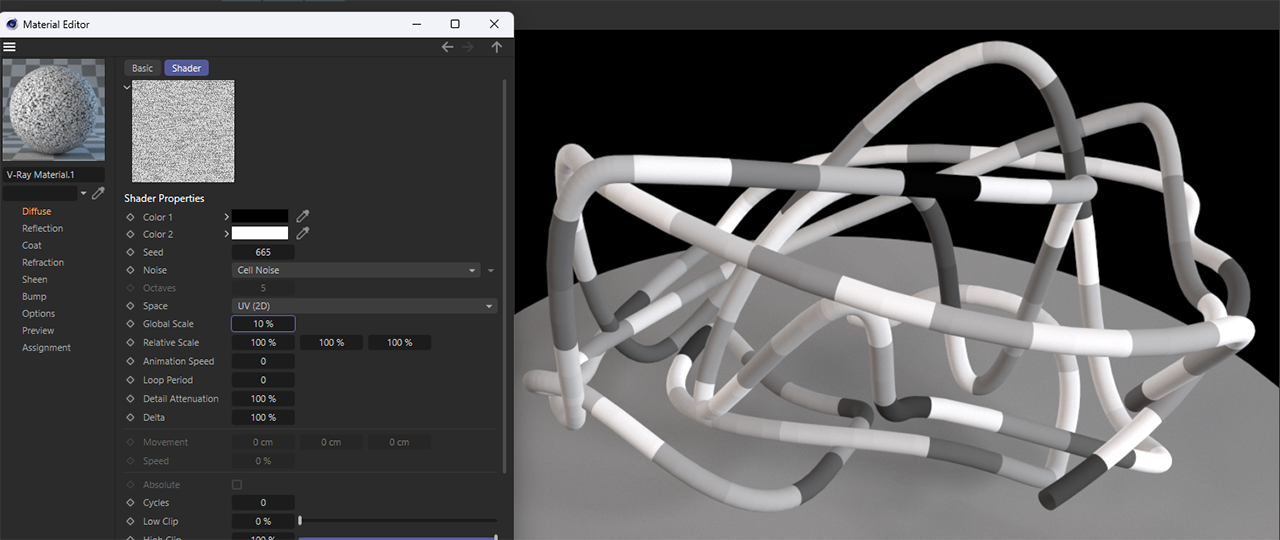

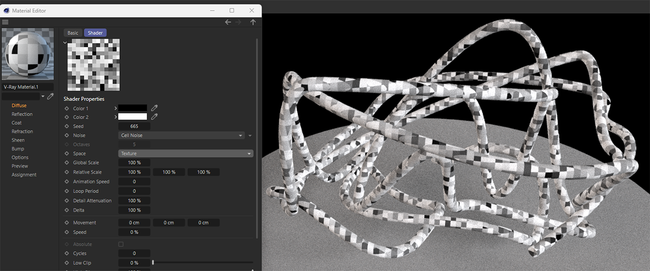

Messaggi: 3568
Re: Help with sticking texture to renderable splines without geometry (Vray 6)
Hi, If I remember correctly, when you use procedural noises on moving/deforming objects they should be set on UV (2D) space, so they can use implicit or explicit UVs and avoid "swimming". I think the problem with renderable splines in vray is that, according to the manual:
A temporary limitation is that only the U size is renderable.
so any texture you apply it's going to be wrapped "around" the spline and not along the length.
Seems to me you can get a nice, well projected noise that doesn't stick or a only U projected noise that sticks...but not both :_)
That might be what you're experiencing.
Screenshot 2024-04-04 105107.png (716.56 KiB) Visto 38971 volte
Screenshot 2024-04-04 105302.png (545.6 KiB) Visto 38971 volte
