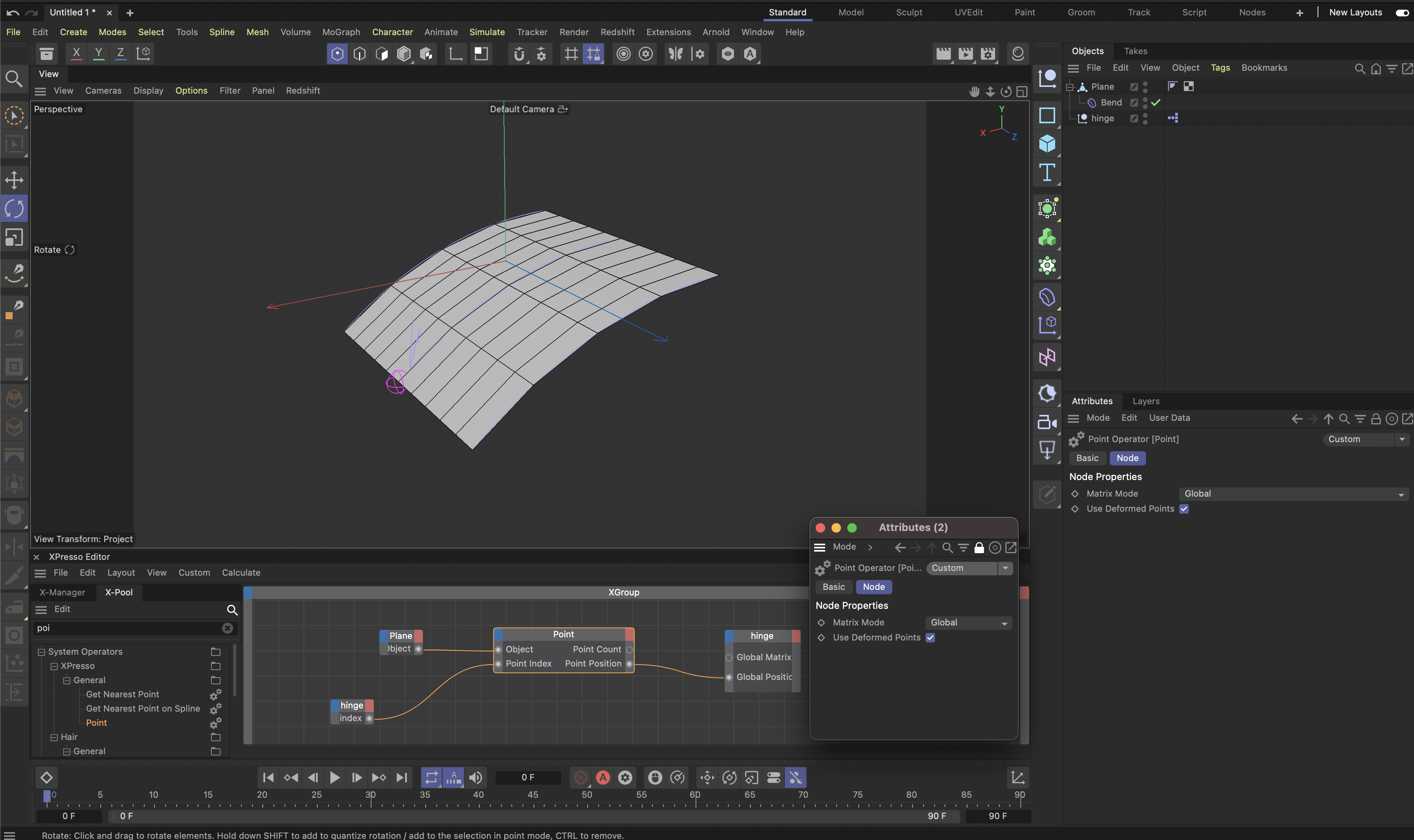

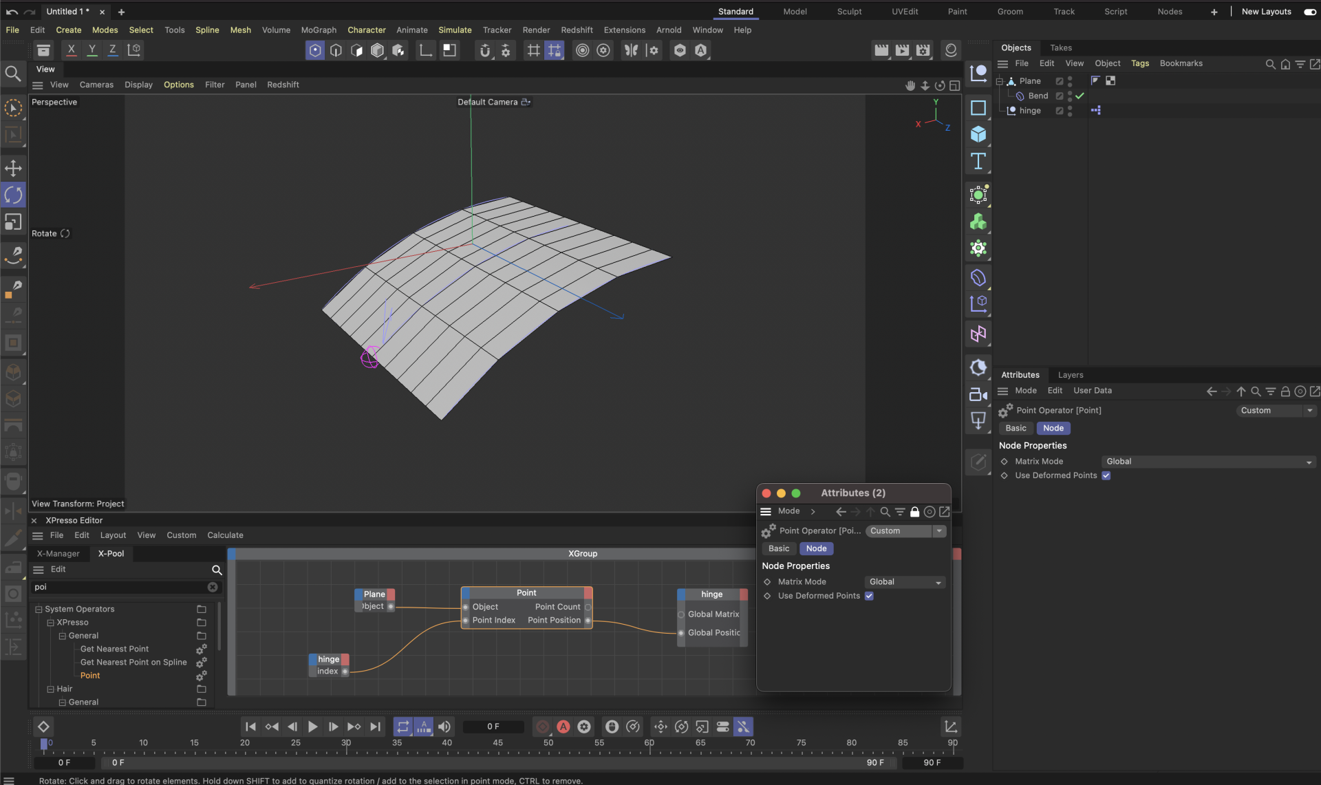

Hi, I might be wrong but I think you just need to check the "Use deformed points" in the Point node attributes.
