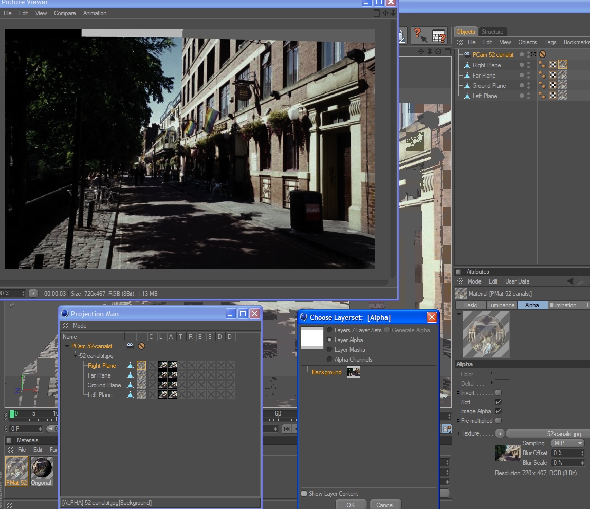

the problem is in the alpha channel.
The picture in the luminance channel is displayed properly, but if the alpha is not appropriate, generates a semi transparent image .
Consequently, the image is darker because it really shows the black background.

I have luminance channel and alpha channel generated by projection man (PM) and both channels show up in the PM window. I am using the new projection/load bitmap option as I already have the origonal photo. I check PM channels and both are set as backgound layer and all projected Luminance and alpha channels are highlighted orange (active) in the PM manager.
The screen capure shows alpha channel for right building projection, as automatically made. Bottom right the alpha settings as set by PM for projection.
Comparing shadow areas of projection and final render as you say it is the dark areas that are incorrect, but what should I do differently to fix alpha?

Re: Luminance material channel
Once you create the material with only the Luminance channel, go again in PM window and right-click the object in question (the one with the material you just created) and this time choose Render Coverage ...
This will render the scene and the image will be loaded automatically in Photoshop (or bodypaint, depends on the preferences you set).
In Photoshop, create a new layer on which to paint the details you want and save the image again.
At this point you will have your C4D object with a new material that will have the picture painted in the luminance channel and an alpha channel automatically generated during the previous trial.
It 'easier to understand trying it, rather than to explain it in words.
