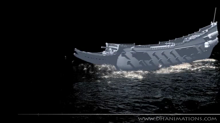

I decided what i wanted from the simulation which was lots of little objects reacting to the front of the ship, then moving down the sides of the ship, some being carried away by the waves..
I began toying with mo-graph dynamics and guess what, it worked a treat. It even managed to deal with the deforming ocean geometry & the actual ship model instead of the proxy!
With some well thought out expresso to tell the mo-graph particles where to start, It even calculates quickly, the render taking under 10 minutes for a 540 frame animation (without sim cache).
http://www.doghouseanimations.com/pirat ... 20test.wmv
Now i do have a couple of questions:-
1. Can the rotation calculation be turned off in mo-dynamics? (to speed up the simulation)
2. The clamp constraint (used to hold my ship to the ocean) produces very bumpy results (seen in the inset clip) even as "phong normal" setting, even though the mesh is quite smooth. Why?
Re: Making waves..
So i've had to move for another effect, this is my 3d sprites (complicated but works out best so far).
It is in no way finished but this is where I'm going at the moment, check the video below for the animation..
http://www.doghouseanimations.com/pirat ... ticles.wmv
