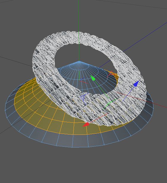

One thing I found is that the generator does not seem to work on round roofs (e.g. cone, see attachment). Is that something that is not possible right now or am I doing something wrong?

You can't make tiles on round roofs actually, sorry :(
Pity, of course, as it would be much more convenient if the plugin could do that, but that's not a big concern right now. If I need tiles on round roofs I'll just generate them on a plane and then use a circular spline (preferably from the round roof itself), spline wrap and an FFD deformer to get the tiles where I need them. At least I think that could be a workaround. Will yet have to test that theory it to see if it works. It should do the trick.
