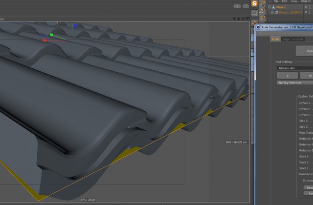

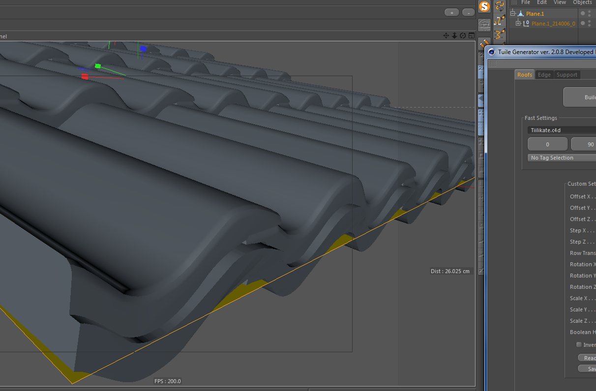

Hi all,
I was wondering if would be possible to have some kind of anchor point from were the duplication start?
I made my custom tiles and I don´t want to show a "booled" tile in front. As you can see in the picture the front of my tile is beveled and is very important for me to keep it but not the overlapped tile.
Maybe is my workflow, I´m pretty new with this plugin. :-((
Cheers
JC.
PS. If the developer need the tile file PM me.

jc4d ha scritto:Hi all,
Cheers
JC.
Hi JC
you can control the boolean cut with Offset Parameters
If you enable realtime update when you change the values you will see in realtime the output...but you need a fast computer otherwise every change may take some time
Messaggi: 10608
Re: Anchor point Tuile generator
Try to use the offset x,z too for to move the whole roof tiles on a direction to obtain a good start.
TuileGenerator starts to make tiles on a different direction based on roof side orientation and there is no a perfect solution to clear a half tile or more.

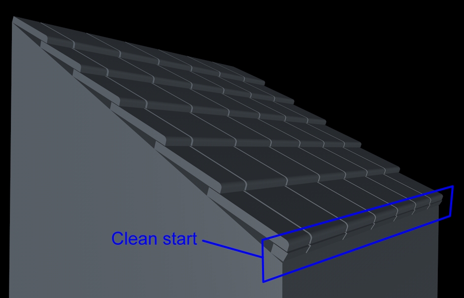

Thank you so much for your answers :) , but for some reason I can´t make it work :( .
Here is a sample file (Customtile is the one that goes into TuileGenerator tiles folder), I would need the tiles overlapped as in the screenshot and a clean tiles start border.
Any further help would be appreciated ;)
Thanks in advance
Juan Carlos

jc4d ha scritto:Thank you so much for your answers :) , but for some reason I can´t make it work :( .
Thanks in advance
Juan Carlos
To correrct this behaviour you have to modify the dima tile.
Open the tile file and move the stepx or stepz tile (I don't remember now) out of the upper base tile.
Try to generate the roof until this behaviour disappear.
Otherwise you have to delete the rest of cut manually

cappellaiomatto ha scritto: To correrct this behaviour you have to modify the dima tile.
Thank you for your tips, I manage to create a "clean start" but then the overlapping is gone. I guess there is no way to have both things at the same time. The good thing is that there is a workaround deleting the starting border manually :)
I would like to add this into the wishlist for the developers, the possibility to choose the anchor point from where the roof is going to be generated. Working in a house company the roof are a important part of the house, like we say the roof is the fifth facade of a house/building.
