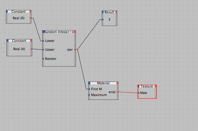

So, I made a simple xpresso expression. Instead of the collision node, I used random integer node to generate random material indices. My only problem is that it is generating them at each frame. How could I make the random integer node give me integers at certain intervals such as every 10 frames?
Thanks

Cinema launch Every xpresso expression at each frame as you note.
Search from the nodes the time and with math operator check that
Frame property module 20 (for example) =0
If true it means that elapsed 20 frames....this could be the main logic more or less
Modules is math operation that mean the rest of division by a number
Es:
8 modules 5 = 3

Math always saves lives! It is working. I just added a NOT after Math:Module, and then connect it to the Enable Port of the Random Integer. Thanks for being so clear and helpful. Here you can see the model. As my last question; would you propose I make selection tags for groups of faces and apply variations of this xpresso or is there any other fancy way?
