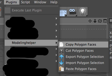

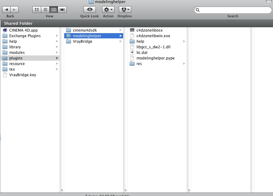

Hello J, it's sound strange for me, i've installed too on my r14...this is the tree of my folder on my C4D, is it the same?
ps: did you see some errors on console menu (script menu) , as E01 or something similar?
