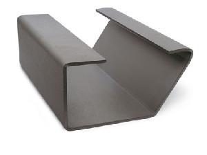

I often need to bend geometry 90 degrees on a rounded curve. For instance the flaps on a cable tray.
Or this object:
Sheet-Metal-Fabrication-Sheet-Metal-Design-Sheet-Metal-Cutting-Sheet-Metal-Stamp-Sheet-Metal-Punch-Sheet-Metal-Bending-Sheet-Metal-Welding-.jpg
Sheet-Metal-Fabrication-Sheet-Metal-Design-Sheet-Metal-Cutting-Sheet-Metal-Stamp-Sheet-Metal-Punch-Sheet-Metal-Bending-Sheet-Metal-Welding-.jpg (5.24 KiB) Visto 4878 volte
Coming from truespace I extruded the plane on a curve and do whatever I like.
But in C4D I am struggeling to find the correct way.
I have been experimenting with the bend deformer, matrix extrude and several modelling steps (such as extruding ones straigt, then up and bevel the two edges to create a rounded corner, but this seems to complex). There must be a easier method.
Can someone please help me out?

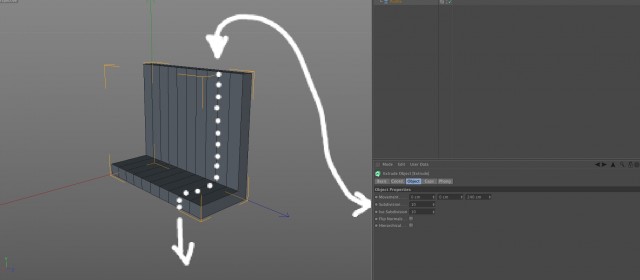

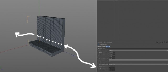

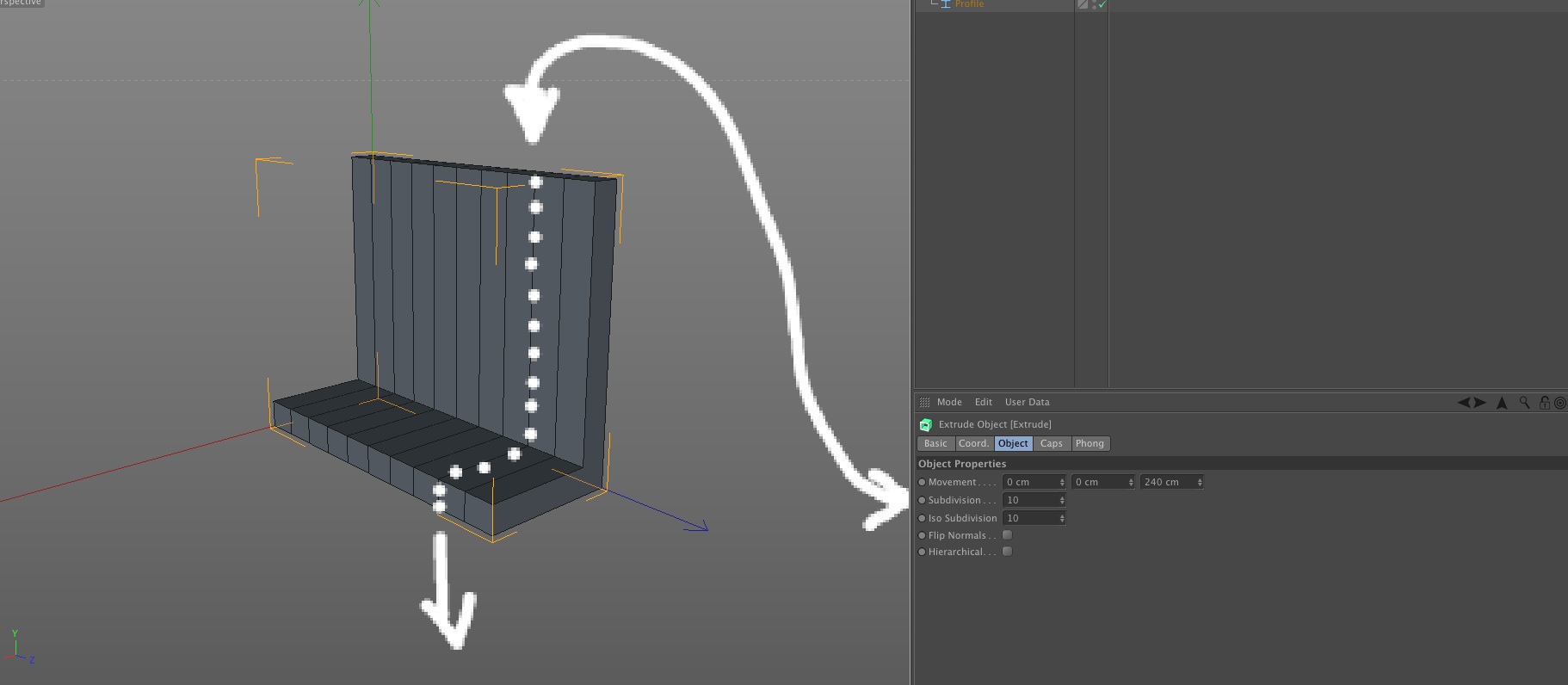

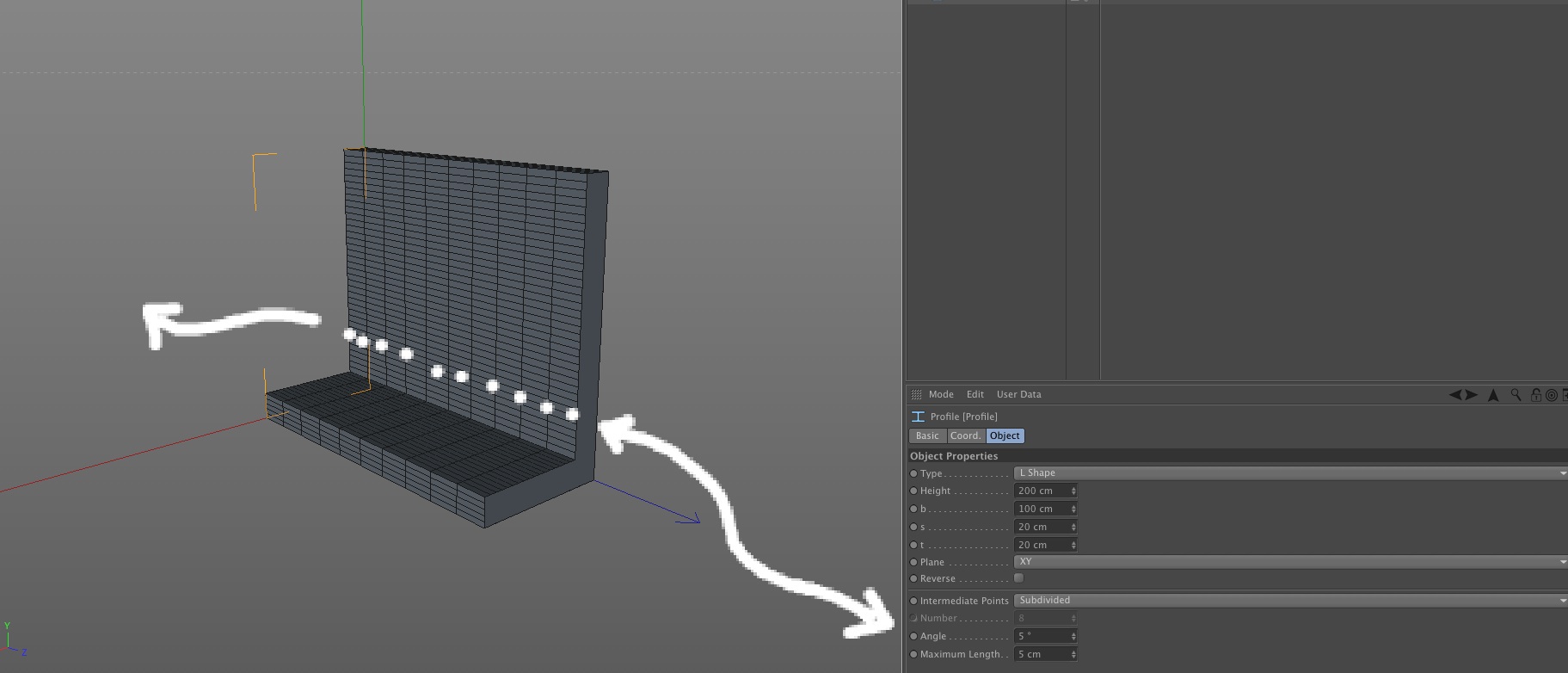

Hello! about subidivisions, take a look to my draft pictures taken from cinema4D editor :)
If you need to bend your object you must subdivide your object my choosing the right way where subdivde polygons. If you use the subsivision into the extrude nurbs parameters the cuts goes in vertical way, if you change the interpolation method into the spline and choose "subdivided" you can cut object into hotizontal way...
I think now that bend deformer doesn't works good because you need to bend the object into two areas... pfiu
