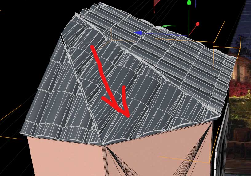

Hello,
I have a problem with the alignment of the roofing tiles.
On the left, surely and in front they are right.
But I do not do the sloping places. The bricks should be put in direction of the arrow.
What must I do, or (still) does not go?
Greeting
Roland

Hi roland
before cover the portion of roof with tiles, enable axis center tool and align axis to the edge
remember that tuilegenerator place tiles following the x and z axis
repeat this operation for each portion of roof if it's not aligned to x and z axis
try and let me know

Messaggio da Roland »
Wow.. thank you... :)
