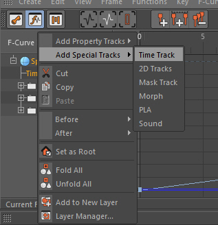

I don't know twixtor so I can't help you a lot....but do you know that in cinema there is a special track called time track which allow you to alter the time directly in Cinema ?
