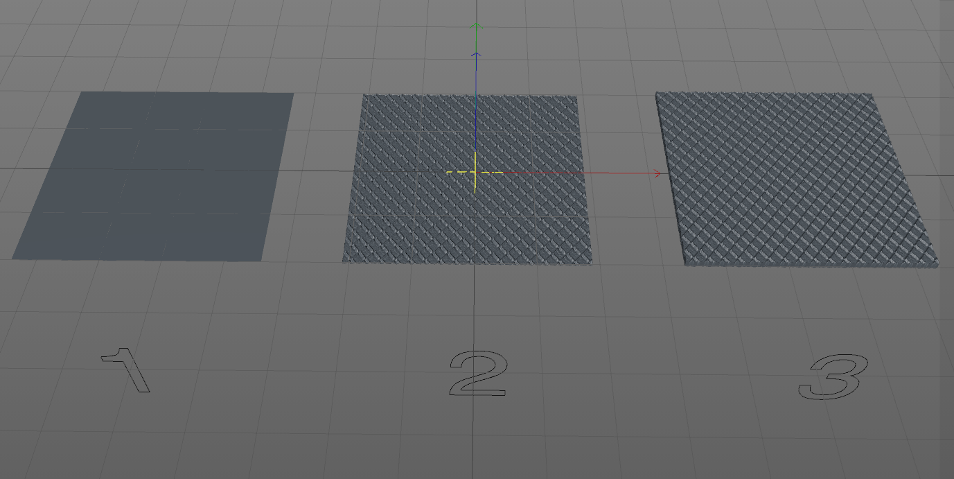

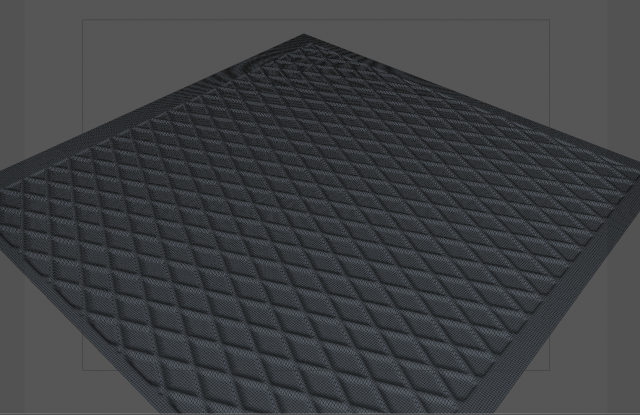

This is what i get, now do i have to select the lower vertex and pull them down to get more shape?.

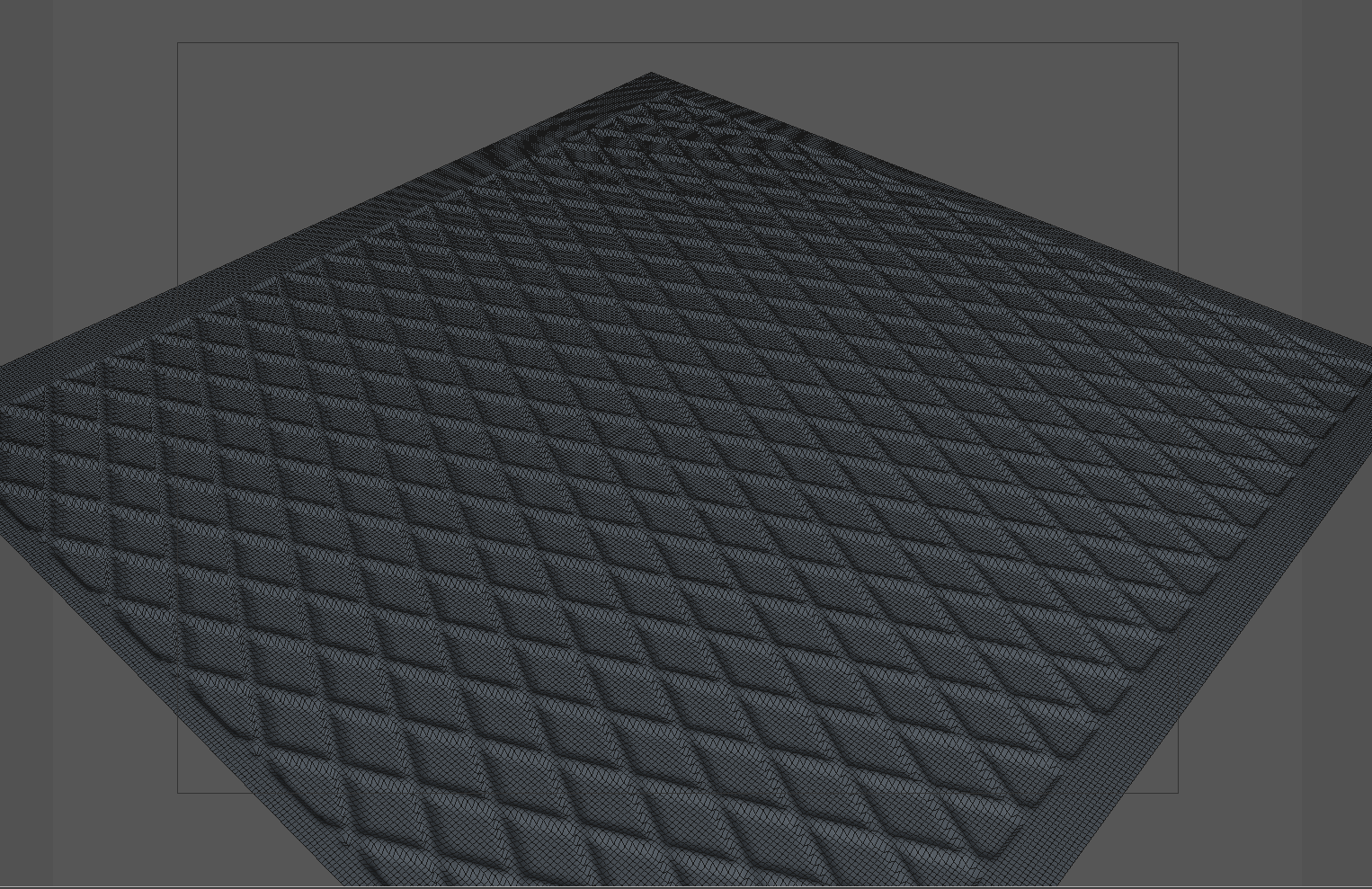

Can i ask you if there is a way to get this ¨ Crush ¨ against waffle cookie chocolate effect?.
Messaggi: 10608
Re: Help Modelling Waffer cookie
Do you mean the "cutted" border? I painted it with a red color
Could you attach a picture about the actual results of your mesh? near the border?
