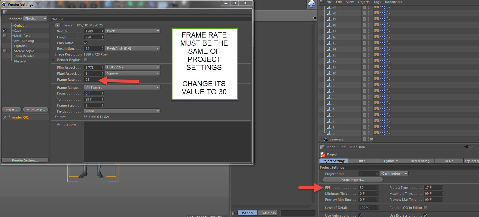

Hey there,
I have a problem with the Obj Sequence Importer 2.1
It imports just fine, the console doesn´t give me any errors.
The live viewer also shows every frame, but when it comes to rendering it just renders every 5th frame, starting from 1 ( 1,5,10,15 and so on)
What am I doing wrong?
Thanks,
Dennis

Hi Dennis
have you changed something in the time setting property of your scene ?
Can you upload here your scene without material?

Not that I know. Tried it several times in new files.
Here a test scene...
https://www.dropbox.com/s/u0zu6j0c4bshd ... 1.c4d?dl=0
thanks a lot

Align FPS of project settings to fps of render settings

Oh man, sorry
Thanks for the reply
