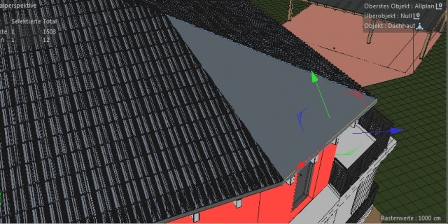

I try to generate tuiles plump to a edge.
But they alway follow thew normal way.
I've seen here a intruduction month ago but do not find it any more.
Can anybody thel me how to solve the problem?
Thanks

The tuilegenerator places tiles along x and z axes
Adjust the axis before placing tiles.
Follow this tutorial
http://www.c4dzone.com/en/blog/videoblo ... -0-355.htm
