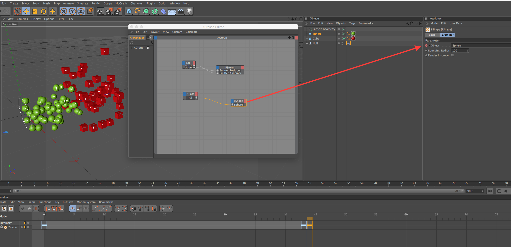

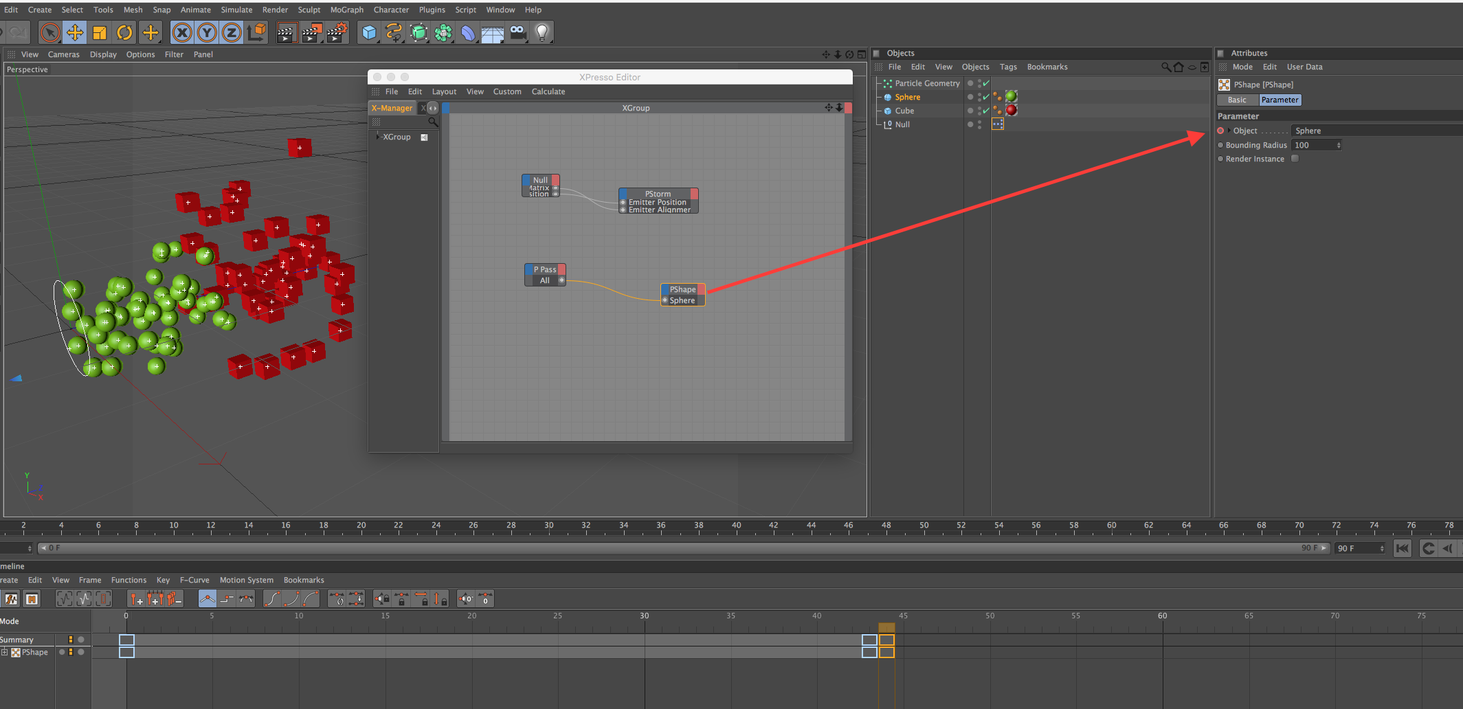

Hi
you have to animate the pshape node property
I attached an example

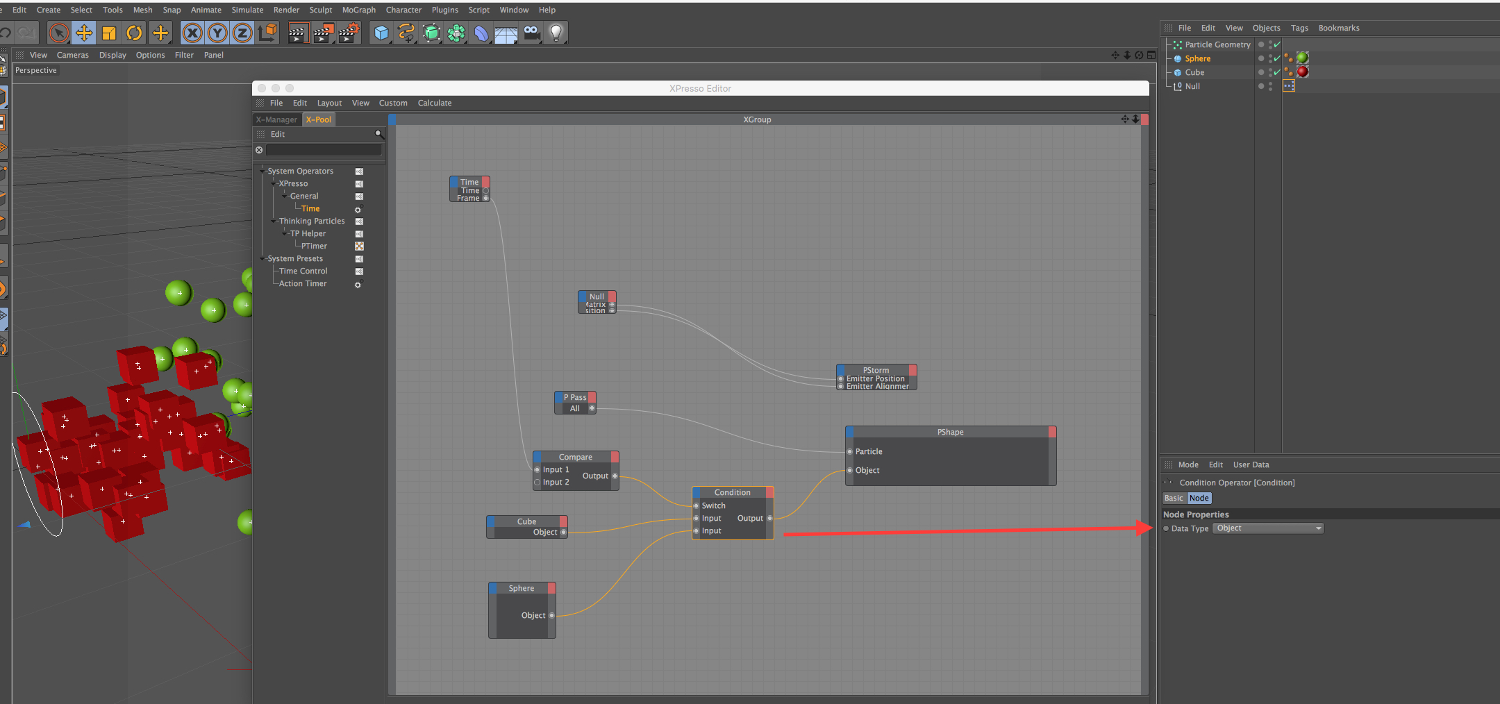

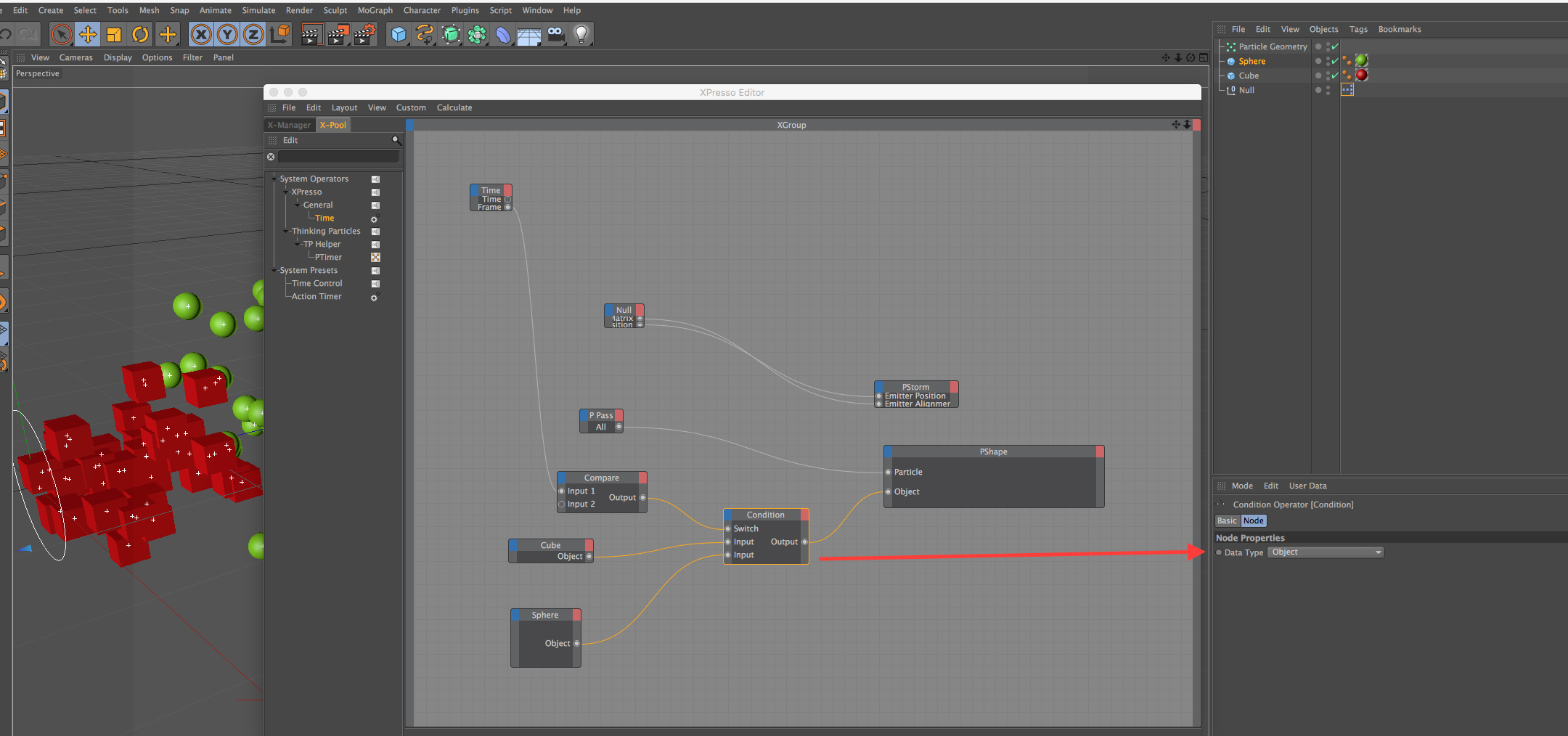

Thanks that helps. But I was hoping to be able to insert a node in between the p pass node and the shape node which would act as what would be a 'case' statement in many languages such as
Case (frame 10): shape (square);
Case (frame 20): shape (circle);
If that makes sense.
Can'y see any way of using "condition" or "switch" to do that?
cappellaiomatto
Messaggi: 1581
Re: Thinking particles
Yes you can
just pay attention to data type of xpresso node
watch the example, of course you can change the condition algorithm
tpshapecondition.c4d.zip
(81.48 KiB) Scaricato 786 volte

cappellaiomatto ha scritto:Yes you can
Thank you cappellaiomatto. That's exactly what I needed and couldn't quite get to.
