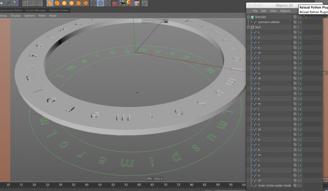

Here's what I'm trying to do...
I am using motext, on a spline around a ring with a spline effector making the text follow the circular spline.
Got that far and hit a road block as I can't figure out how to then take the text and use a boole to subtract the text from the ring.
I have attached a screenshot of how I have everything set up thus far. Thank you everyone.

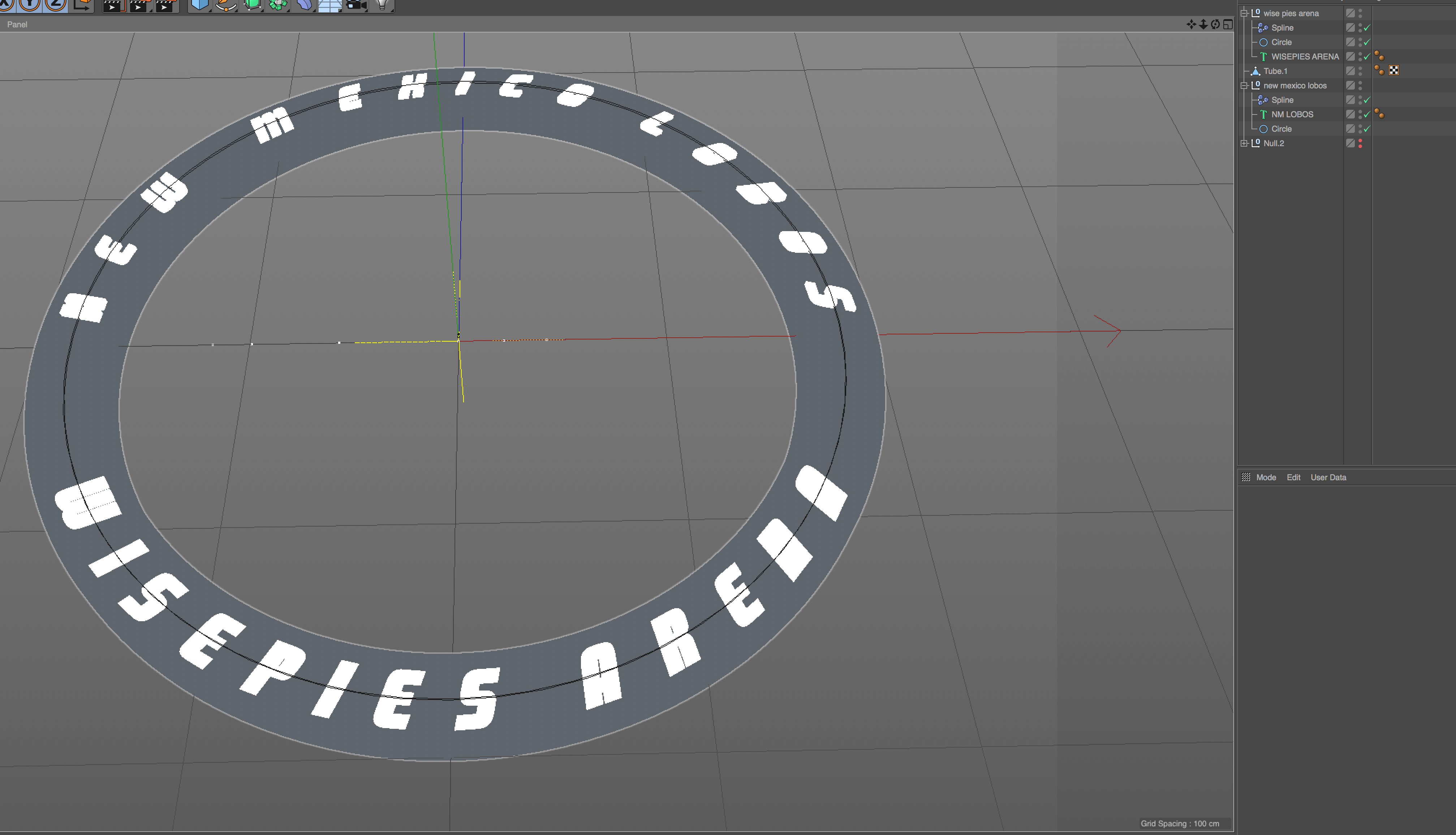

Hi, I think you will have far better luck using just splines and extrudeNURBS, especially if you have to animate it.
