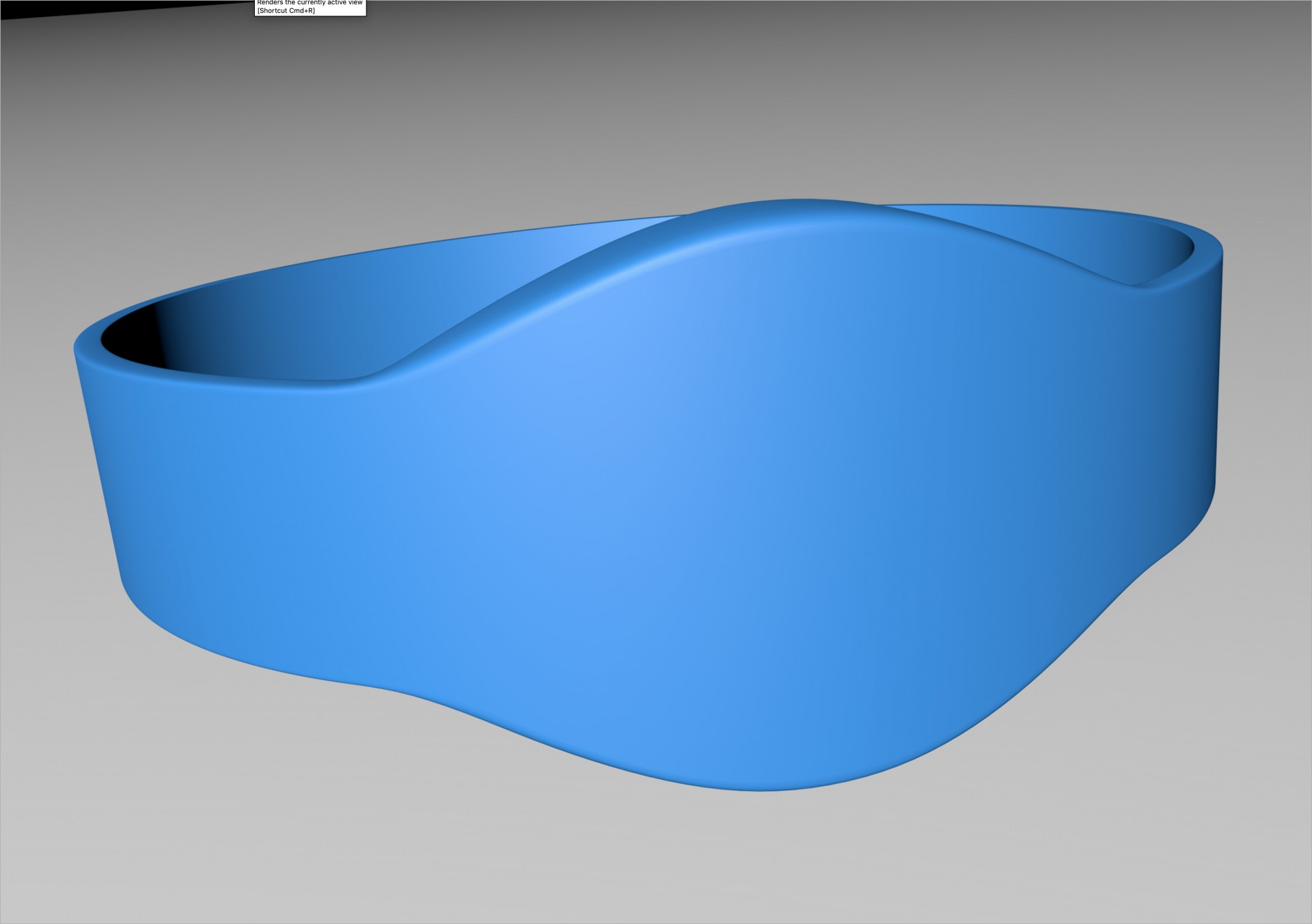

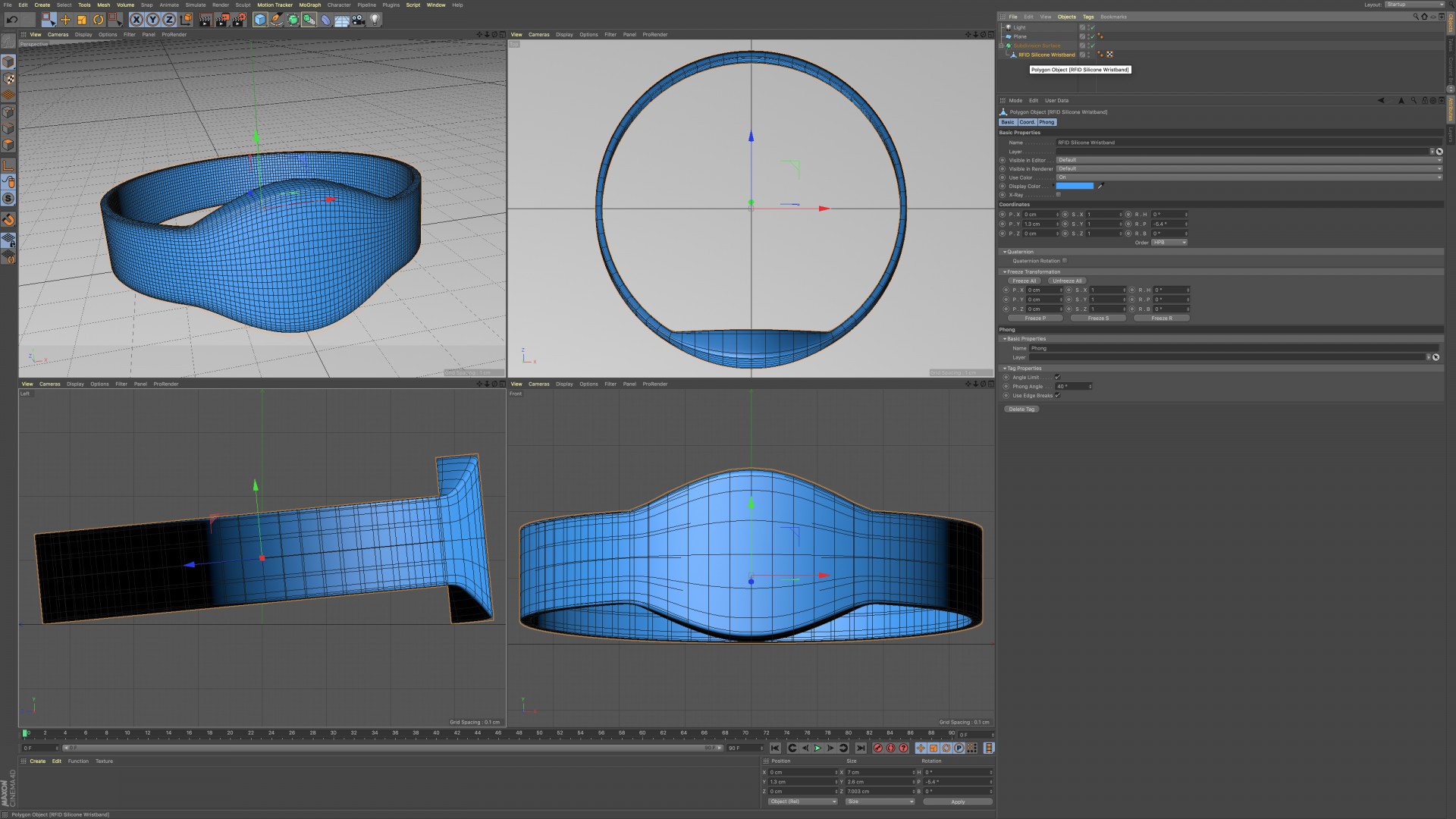

The best way to model that kind of object is using polygons modelling with SUBD (Subdivision surface).
By starting with a flat circle and create a hole you can make an extrusion of the first shape and adjust edges, at the final steps I used a subdivision surfaces and make cut with knife to make hard edges of it.
Look in to the file attached here I have created all steps from left to right :)

I got it to work, used exact coordinates for the curved parts. Now it is real size and flawless...
Learned a lot today, thanks a million. Confident I can do the other version now.
