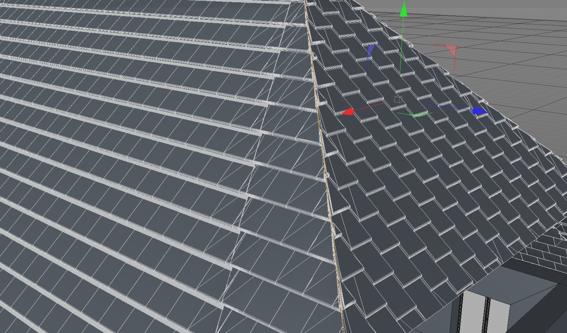

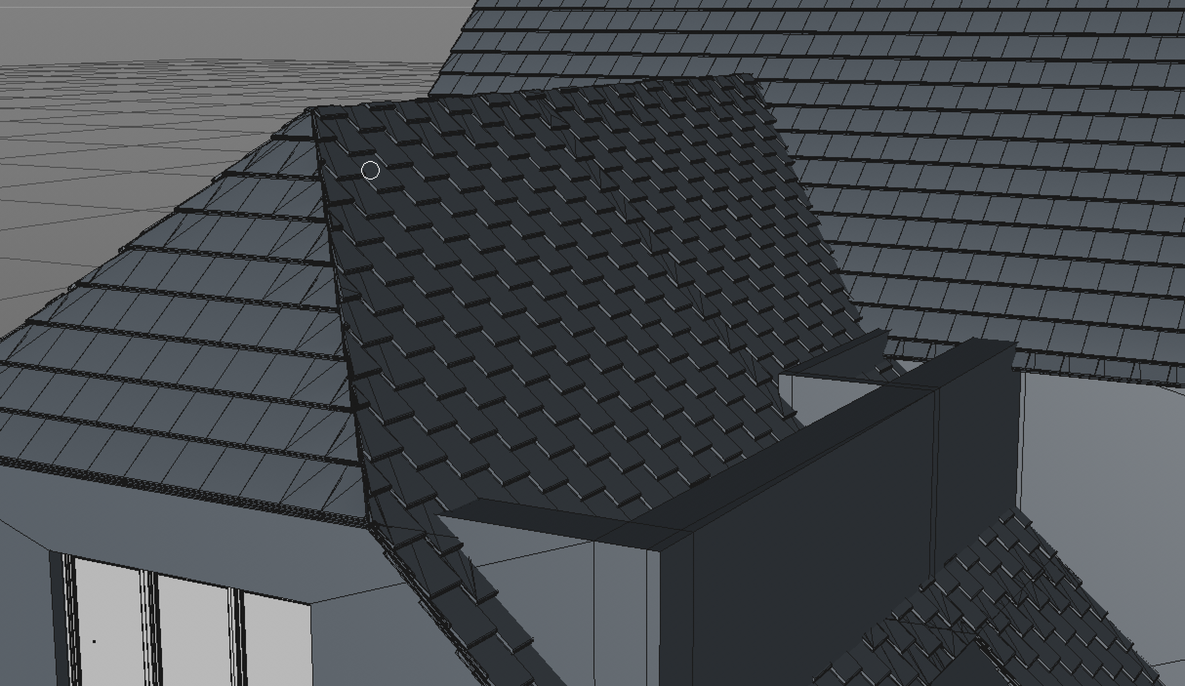

I've just started using Tuile Gen, sorry if this has already been answered but struggling to find a solution.
I can place tiles on one side of a roof just fine, all settings are fine. Then I go to another side/plane and apply the same settings and the tiles come out staggered.
Has anyone else had this or know of a solution?

Hi
The tiles distribution is made according x and z axis direction.
Take a look at this video that explain how to change axis orientation to fit the tiles distribution for your needs
https://vimeo.com/125254837
If you still have trouble feel free to write me an email at this address
Matteo at c4dzone.com
