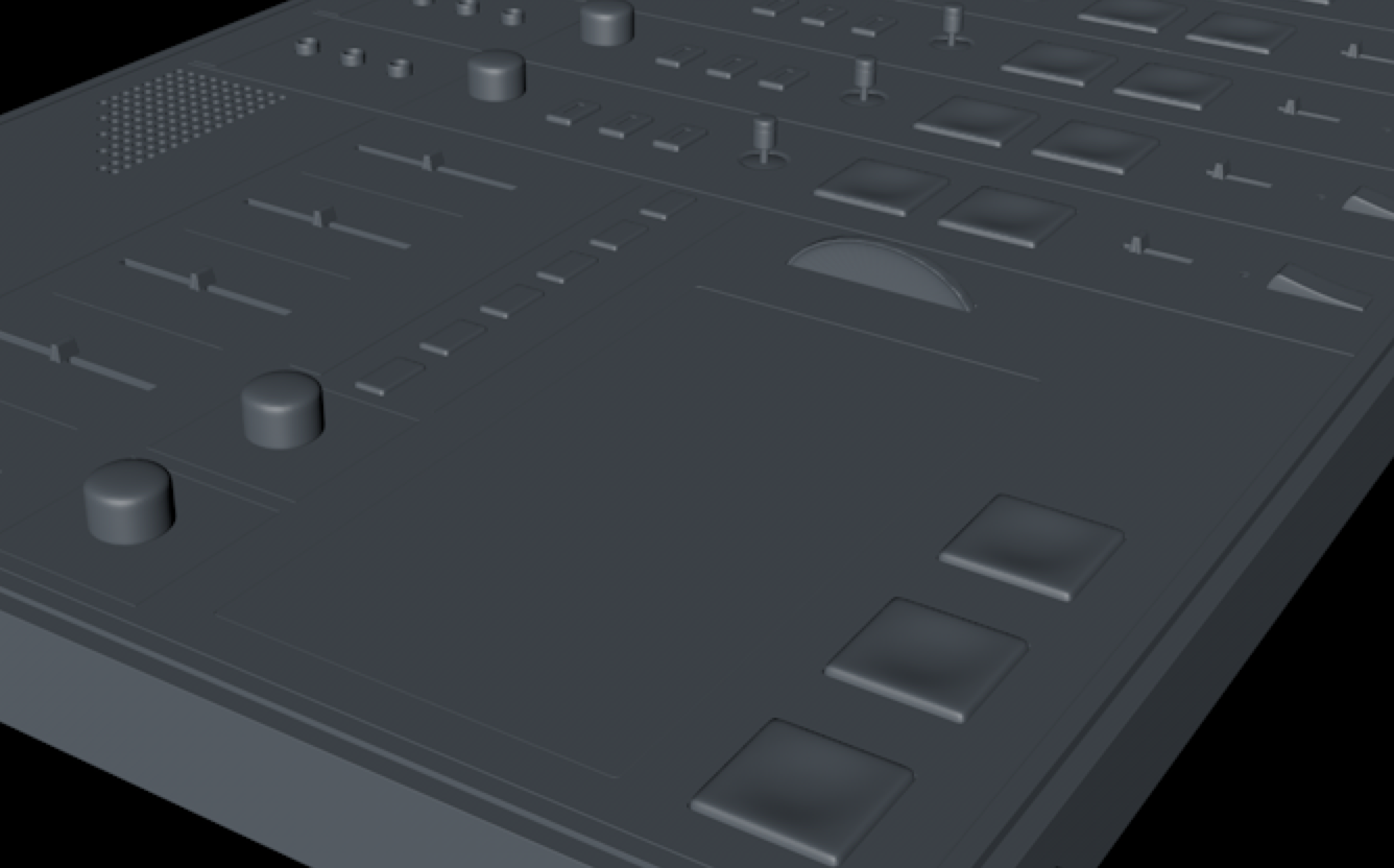

Starting to get a little frustrated. Have been modulating in cinema on and off for a long period now and thought I did everything right, but I'm probably totally wrong. Learned myself trough YouTube and a lot from different forums. Trying to create a simpler synthesizer with a few buttons and controls. Mixing regular modulating whit bevel the edges manually and where I create some buttons with subdivision surface.

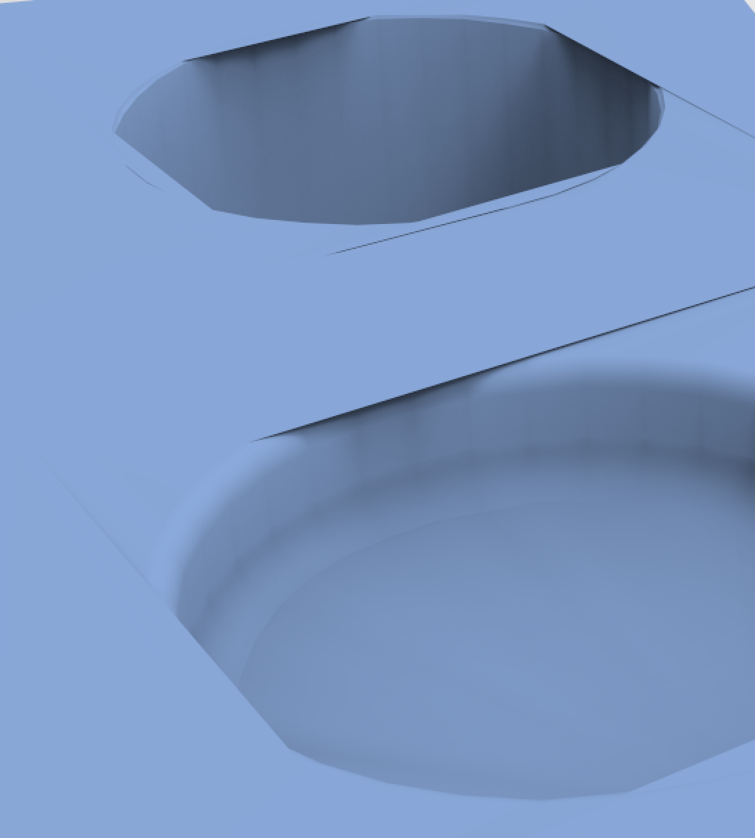

And now, when I'm almost done and I export it to keyshot (obj-file) it either goes slow (the file is to big) or it looks fucked up in keyshot.

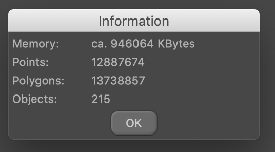

- Yes, you have too much polygons, 13 millions of poly is a very high mesh and handle this kind of file to another software can drive it crazy. If you want optimise the file you need to "clone" the similar objects by using "rendering Istances" but this works only if you stay into Cinema4D for rendering, if you export the file all become polygonal object.

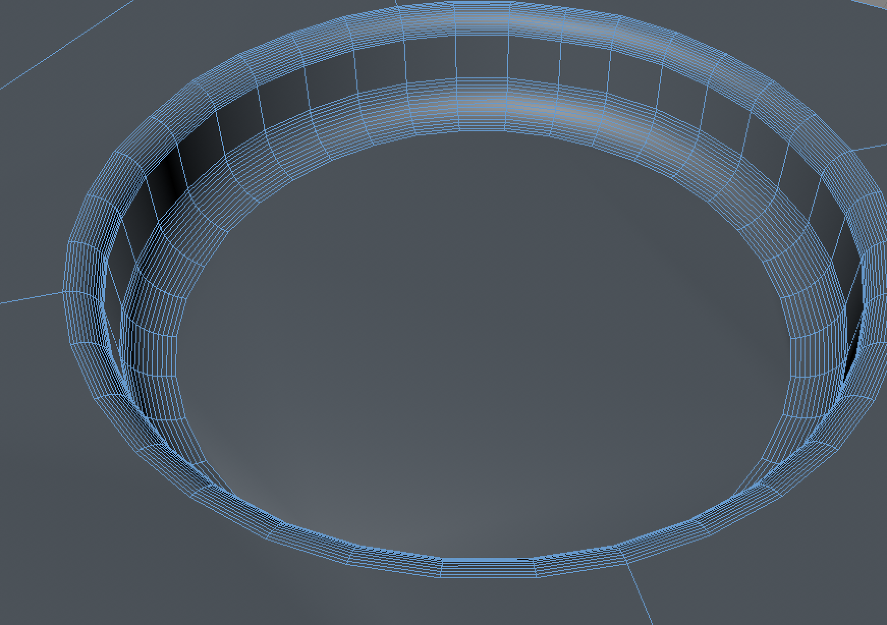

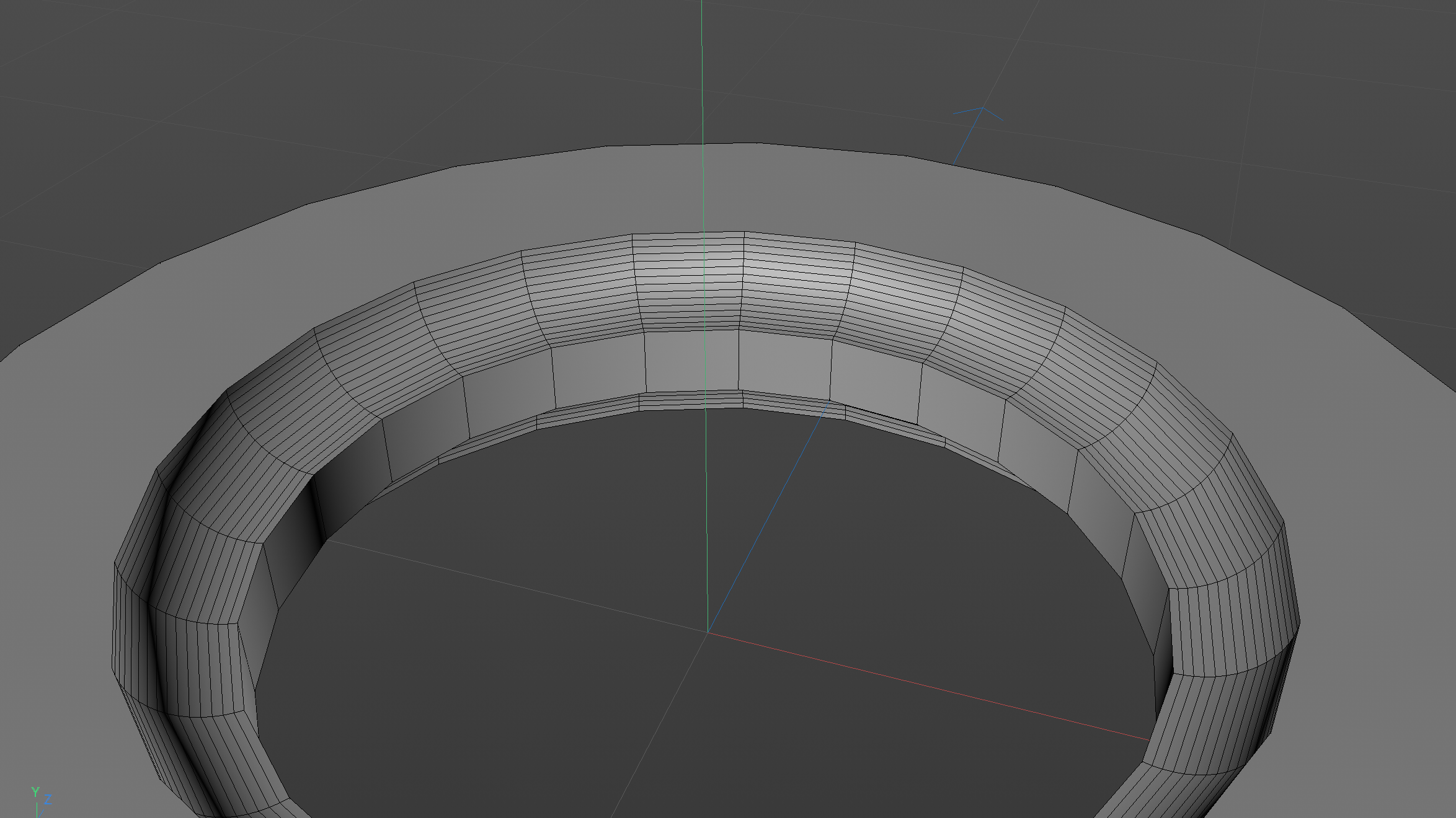

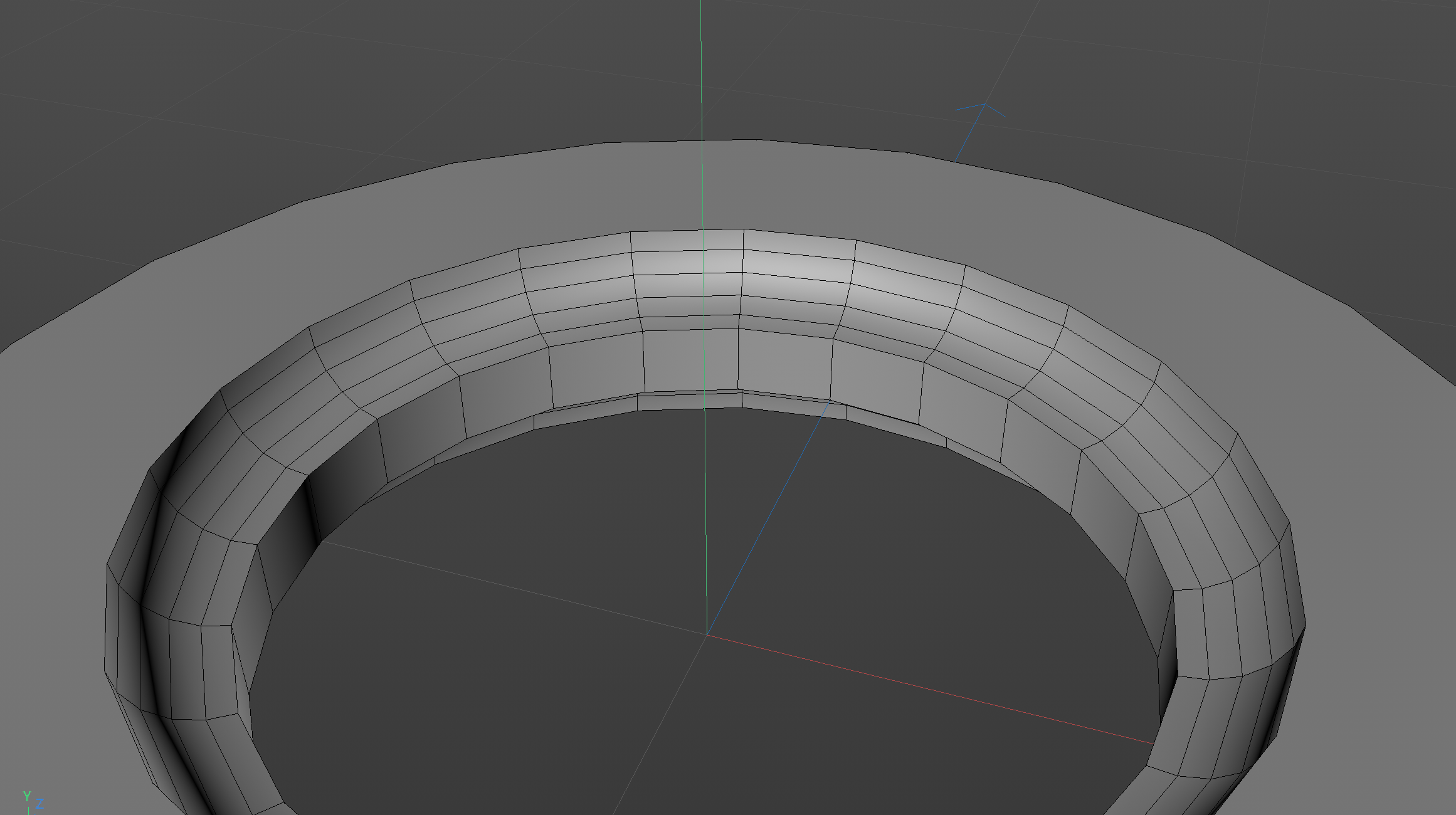

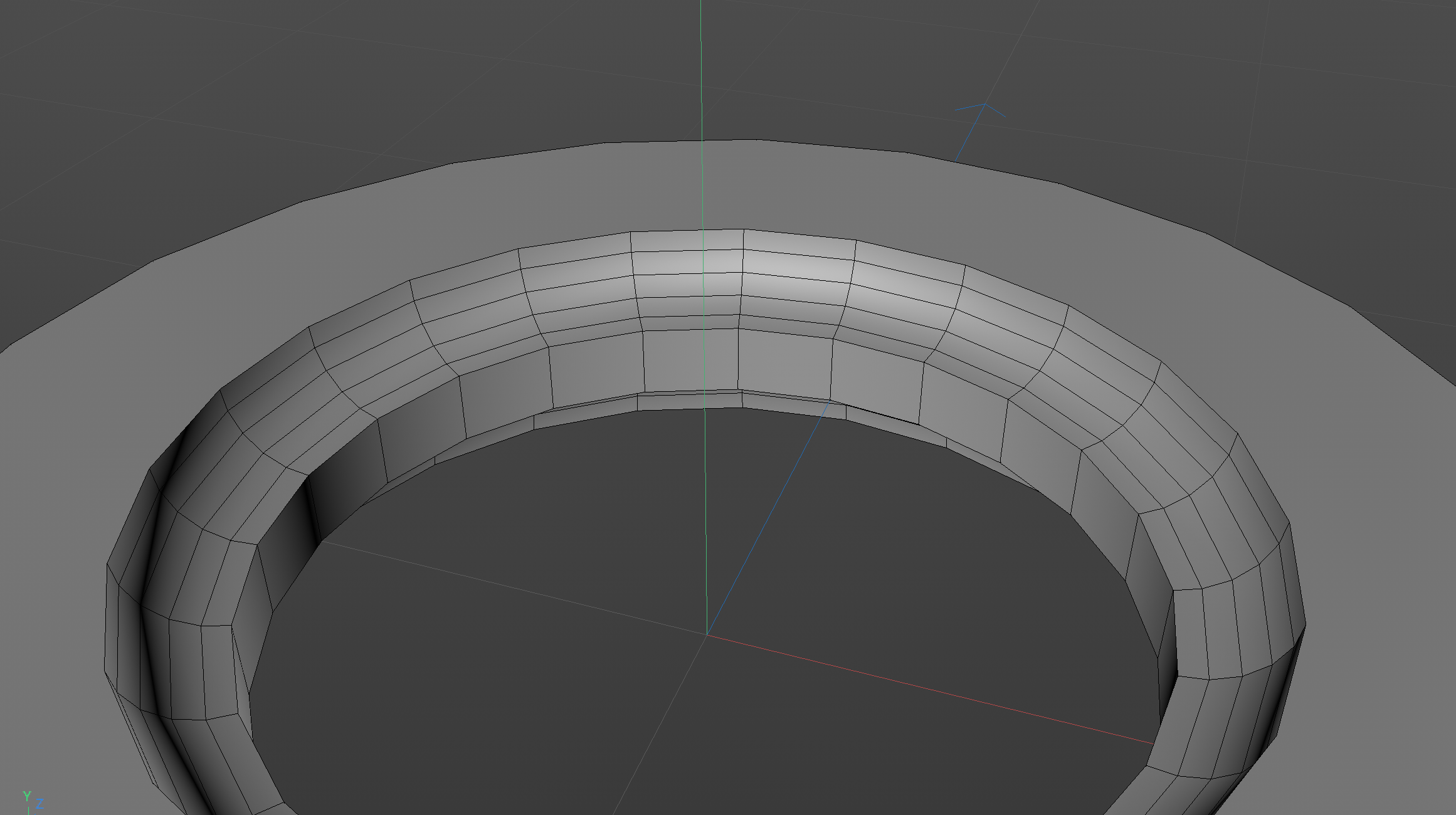

About your question, maybe Bevels are the problem here, but the only way is to reduce them as possibile, for example you must reduce the bevels count, in my attachment you can see a 5 steps bevel and 15 steps bevel (as you).
With 5 steps you can get a good smoothing curve as well.

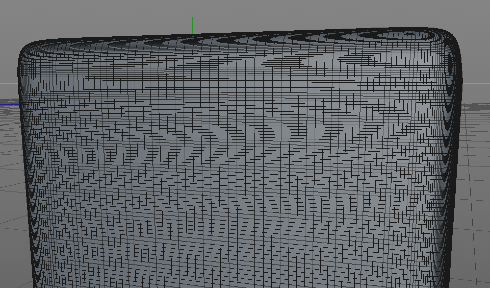

If you have subdivision surfaces with a polygonal object inside for smoothing, try to reduce the render quality to 2 instead of 3, this will take place when you export to OBJ, so take a look to the "editor subdivisions and render subdivisions" of each Subdivision Surfaces object and use 2 on the rendering subdivision to get few polygons during export :)
