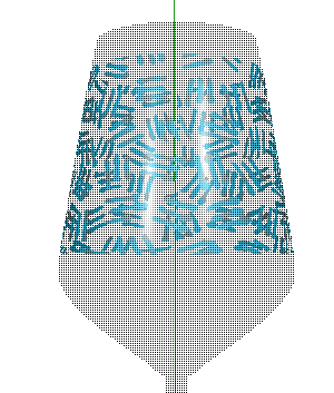

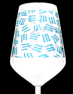

Here is my problem : I need to apply various pattern designs on 3D glass models
Here's what I'm looking for : https://imgur.com/l2PlG6n
Here's the issue : https://imgur.com/XeO5OwC
I use UVW Mapping on my pattern's material with "Simple projection" and side to "Both" with the "Tile" option.
On some models, the pattern get distorted, much bigger on the parts that are rounded, not plane (maybe this is the reason?)
There's also some dots that shouldn't be here. You can see the original pattern : https://imgur.com/iuYWnzi

Hi Tom, welcome aboard. The problem is the projection, if you are using UVW mapping you need the unwrapped UV otherwise distortions occurs. If you are not into the UVW argument you must change your projection on something else like Cylindrical mapping to avoid distortion. Let me know :)

What do you mean by unwrapped UV? I tried changing the projection to cylindrical, sphere and all the others but the only one that gives a realistic result is UVW mapping, the others are distorting the pattern a lot. Frontal is the only one that keep my pattern normal but of course it isn't realistic since the pattern isn't following the object.

Here you can see the glass model without and with the pattern added : https://imgur.com/a/nm3GZv8
I don't understand why the middle zone is working while the rest is taking the orange or dark grey color from the pattern with huge distortions.

Hi Tom, I think this issue is definitely bad UVWs so you need to unwrap them...
As said before , what about Cylindrical mapping? if you apply on it with Cylindrical projection you can right click into it and choose "adapt to object" for a good placing and after you can use tag percentages for change the size :)

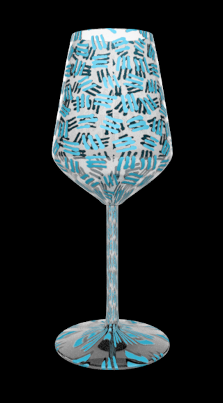

Thank you so much for your time, it works fine using cylindrical and fit to object ! But I still have an issue with some black dots appearing on the render. I never saw such a thing, maybe due to the glass transparency or something like that ?

Sorry I'm quite a noob, didn't played with C4D for a long time..
My pattern gets black on the back of the glass. I just changed the glass material a bit but not sure this would make this black. Also switched my render settings to physical. But at least the dots are gone !
