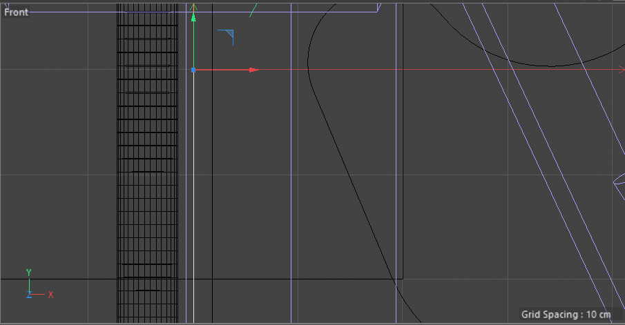

Hi All,
Looking for some help with my current model (new to C4D) I'm following a simple spine rigging tutorial and the spline isnt moving. Any ideas why?
Im in model mode which I believe is right.. and the XYZ arrows will move, but the spline just stays where its at?
I just connected this specific spline to a spline wrap. put the axis on -Y and Banked it to -95.
Any help is much appreciated!
thanks!
before moving spline

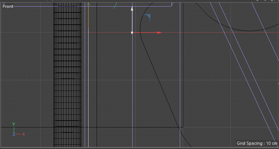

after attempting to move spline

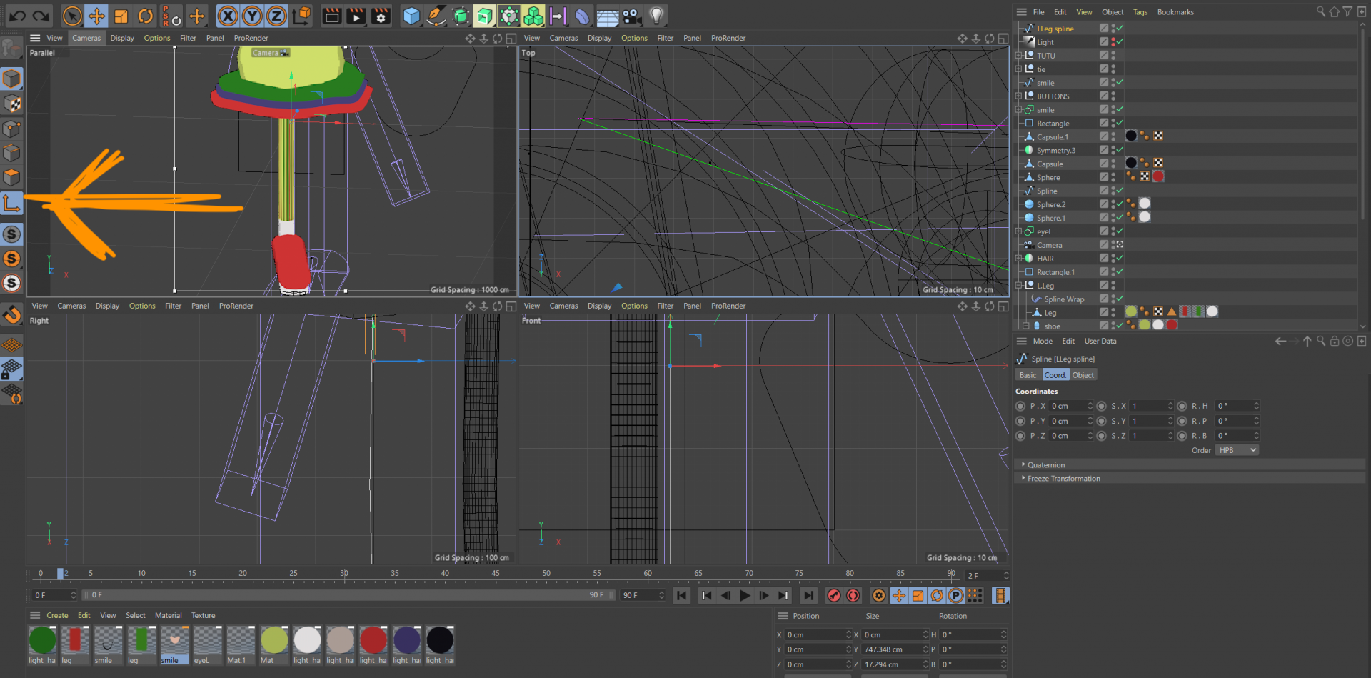

Try to turn off the "AXIS MODE" button on the left of the screen below the point, edge and polygons tool. :)
Alex
