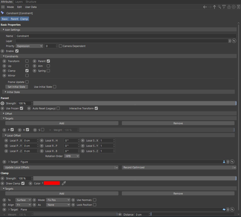

I was wondering how i could attach an object to an animated character. I want to attach a shopping cart to a walking character. I used a constraint tag on the cart and attached it to both hands of the animated character. That work great but now the shopping cart is moving with the character. Like up, down, side to side instead of straight along the floor path. I want the characters arm to move and not be stiff but the cart to remain attached to the floor. Like how it is when we move a shopping cart at the store. Any idea how i can make that work? I would greatly appreciate it.

Hi, just add a second constraint (clamp) to the flat object (to the surface on which the cart must remain attached or to a substitute for it), even in the same tag.

I will try this. I wonder if it’ll work. Thank you for the suggestion.
