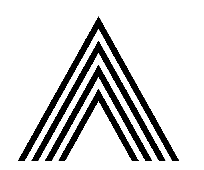

Hi, i'm making a 3d version of a logo and i'm going for a round metal style.
this is the 2D logo:

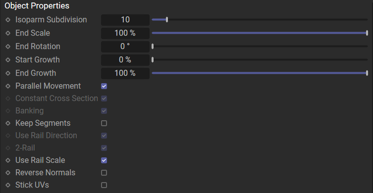

my plan was to use sweeps, so i plotted lines in the middle of the original ones and created this shape using these settings:
sweep settings.png (45.34 KiB) Visto 32836 volte

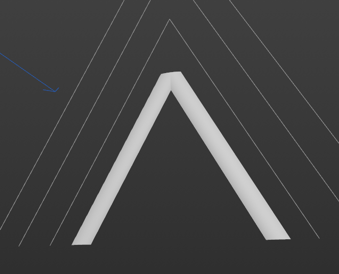

this result is pretty much the one i want, but it's missing the point. tried tweaking all settings and the ones which get me the pointy top mess up the rest and don't even get the point right.
any suggestions?

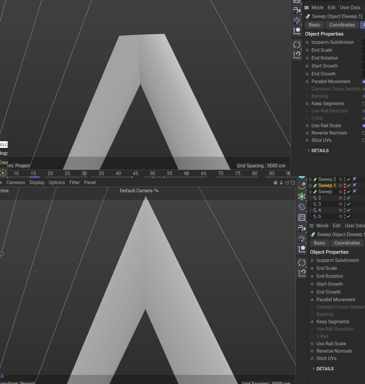

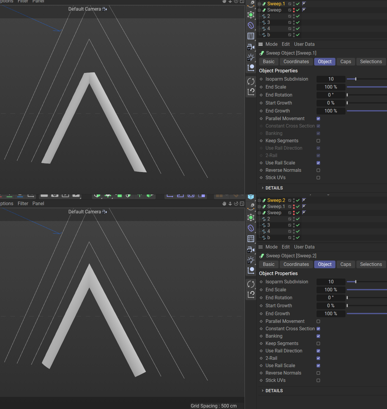

Thanks for replying, but that was one of the settings i dismissed because:
1- it messed up the bottom and i wanted to see if could achieve it without resorting to a boole
sweep comp1.png (325.65 KiB) Visto 32876 volte
2- it makes it lose the crease i liked in the pointless version
sweep comp2.png (349.97 KiB) Visto 32876 volte
